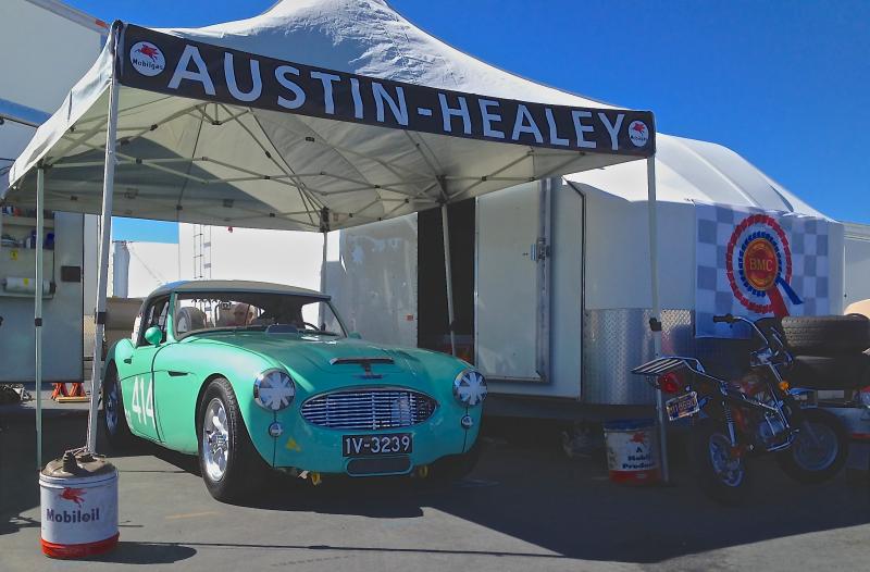

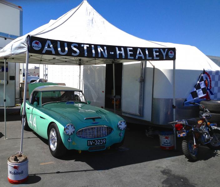

I love using an enclosed trailer for long hauls. When heading south to Cali or east to Road America the enclosed trailer is the only way to go. I have an open trailer as well, I use to go to the dyno or the local track, PDX. An enclosed trailer offers not only a safe car hauler, by a safe place to store tools, spares, and cold beer on a three day race weekend......
An enclosed trailer offers........a safe place to store.............cold beer on a three day race weekend......
