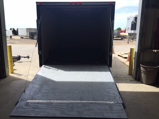

Patrick , A "race car" type with the drop down door/ramp also has a beavertail deck which is a must for a Healey's low ground clearance. A cargo type trailer has too sharp an angle to bring the car up without fouling it on the edge. You'll be able to drive the car up and in , then be able to open the driver's door to exit. Kevin

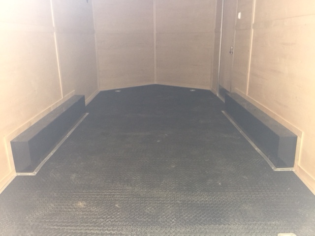

Kevin, Here's what I was looking at but only shorter(16/17/18). The platform is 18" in height. I believe Race Car trailers are similar spec'd but the interiors of those trailers are tricked out(cabinets, AC, etc.).
https://www.continentalcargotrailer.com/default.asp?page=models&unit=valueauto&choice=home
The "Value Hauler" salesman was very specific that the 8.5 wide trailer would have a low platform for me to drive the Healey up into it.

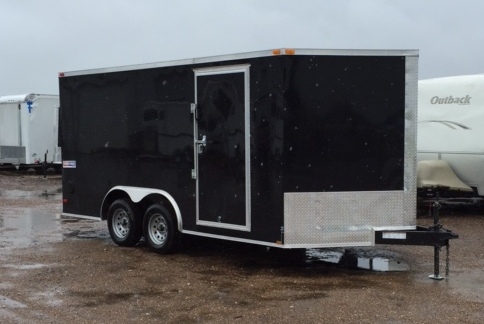

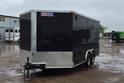

Kevin, Here's the trailer I was looking at. It's a race trailer with "no frills".
https://www.wacobill.com/Value_Haulers.html

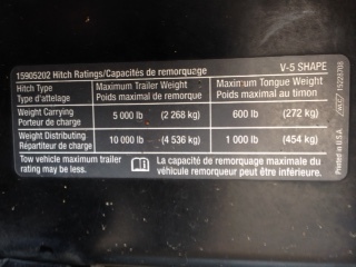

This is the label next to the hitch.

Your hitch ( which has nothing to do with what your Tahoe can tow btw) is rated for 5,000 lbs. and 600lb. tongue weight. That means just a 2" drawbar and a 2 and 5/16" ball. You can add a weight distributing hitch with torsion bars and increase the hitch capacity to 10,000 lb. and will make the loaded trailer tow much better. I just checked the unloaded weight of my 20' x 8.5' United hauler ( essentially the same construction as the one you are looking at) and it is 3160 lb. so you will be overloading the hitch on your Tahoe without a weight distribution system. Your Tahoe will indicate on a tag on the glovebox door what exactly it is rated to tow. I would think around 6,000 lb. would be the max. so you should be fine.

I checked the glove box and nothing there for towing and I checked the drivers book and it says with the package I have, K5L HD Cooling pkg, it is rated at 8400 lbs "maximum trailer weight". I'll stop by the place I looked at trailers and ask them about additional equipment, if needed, to safely tow a trailer and what kind/capacity, etc. Thanks for your input!
