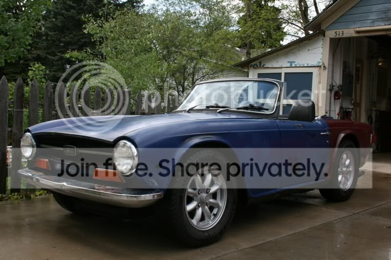

Here's a pic of the wheels on my 6. Please disregard the shabby condition of the car -- look only at the wheels :smile:
Anyway, they're MiniLite replicas like you'd get from Moss or TRF -- don't know from where because they came on the car. They're 15x7s running 20mm of offset where stock would be 6mm. Tires are 215-65R15. The only rubbing I get is the front wheel rims on the upper A-arms which could be fixed with a little judicious grinding on the arms. I'm going to sell these wheels, though, and go with Panasports and 205s instead.
Steve

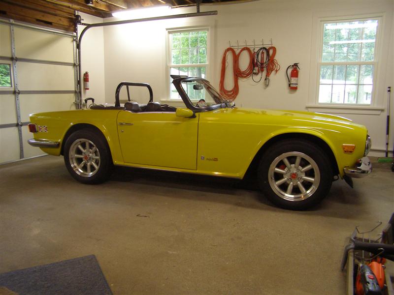

Todd,
My car has new stock springs and is not lowered.
I got my wheels, and Falken tires at Discount Tire on line. They were the best price by a few hundred dollars of anyone. Tires came wrapped in paper, with wheels protected by cardboard and individually banded, as well as being mounted and balanced. Two needed to be rebalanced, but that was minor.
No rubbing at all using the zero offset wheel.
Brosky said:
Todd,
Thanks Paul.
One more quick question... do you have a part number for those wheels? I'd like to find the dimensions for them.
Thanks again!
Todd,
Here you go:
Four (4) Product code 73407 16X7 4-114.3 Konig Rewind RW7611400S $116 each
Four (4) Product code 18130 Falken 205/60R16 ZIEX ZE 912 Black Tires $66 each
Four (4) Product code 80017 Free Replacement Certificates $9.50 each
Four (4) Product code 80145 TR13SC 500 Chrome Vale Stems $3.00 each
One (1) Product code 85426 Installation lugs $0.00
Shipping and handling to Mass $88.96
Total including mounting and balancing $766.96
It's Discount Tire Direct and I bought mine last year, so they were cheaper, but I think that they have free shipping now, so you are even or ahead a bit.

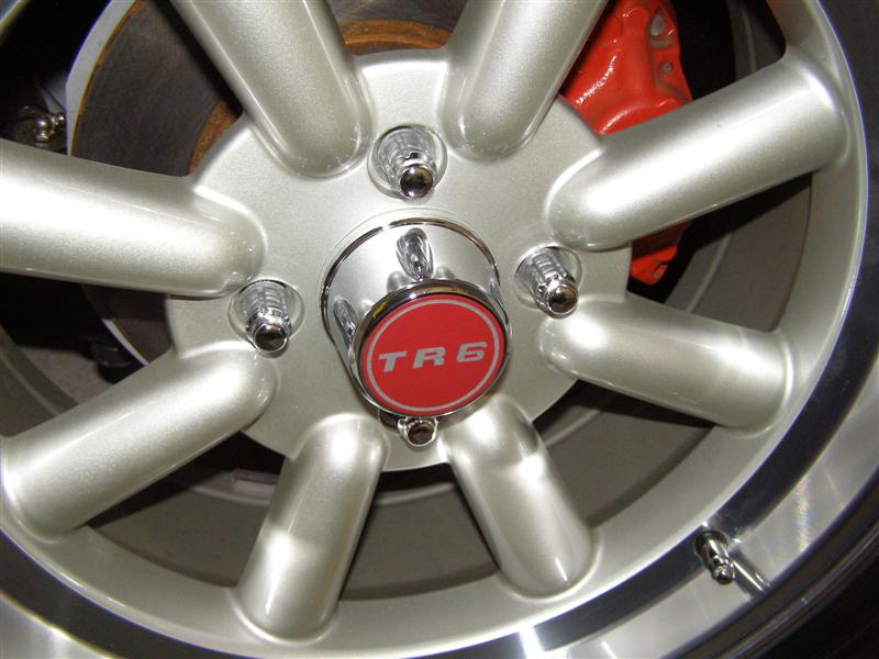

Paul: Those wheels are beautiful and the price sure is a deal! Tell me. Are they alloy? Aluminum? How are they finished? Paint? Powder coat? Any modifications to suspension, wheel hubs or wing sheet metal necessary for fitting?
Thanks,
Frank
Frank,
They are the same alloy Konigs pictured above, but with all silver instead of the dark center spokes.
These are better pictures to show that is is not a pure silver color, but slightly off that tone. And yes, the centers of the wheels are baked on powder coating.
