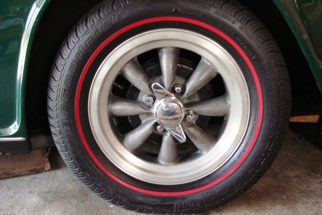

not TR6, but here is a photo of my TR260 with Goodrich redlines, 205-65R 15 on AR Silverstones.

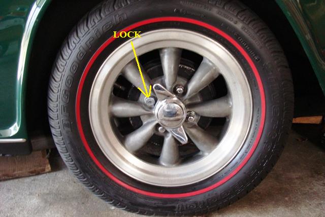

trfourtune
Frank,
you better put 4 anti-theft nuts on each wheel before i steel those baby's. LOL
I LOVE those wheels! (don't worry,i'm about 3000 miles away)

angelfj1
trfourtune said:
Frank,
Rob
I understand and I did.

trfourtune
Frank, I saw that you have one lock per wheel, i said 4 lock nuts per wheel. LOL

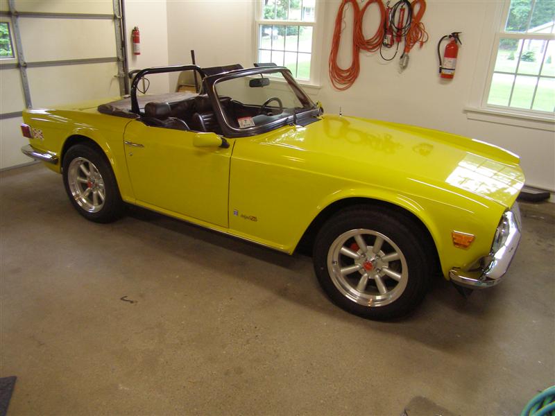

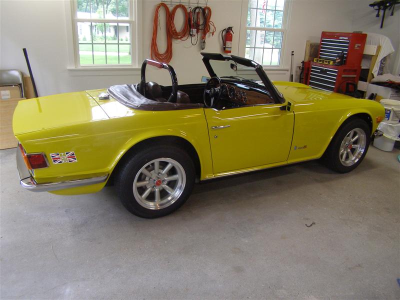

Brosky
Tab,
I have that same wheels (16"X7") on my car, but in silver. I don't race it, but a call to Konig will answer that question.
