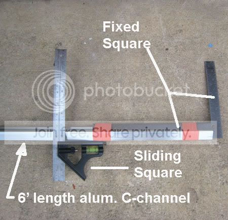

Here's a follow up photo of installing my tie rod ends.
I built this gizzmo to align my front wheels while
fine tuning my tie rod end's final position.
As Randall stated, I installed my tie rod ends imcorrectly,
but somehow I have no steering shimmy until 70+ mph and I have
no odd tire wear. That suits me just fine.
Again, I'm not an auto mechanic and there are NO Triumph
mechanics within 1,100 miles of me. My Do-it-yourself
techniques seem to work pretty good.
best regards,
dale
