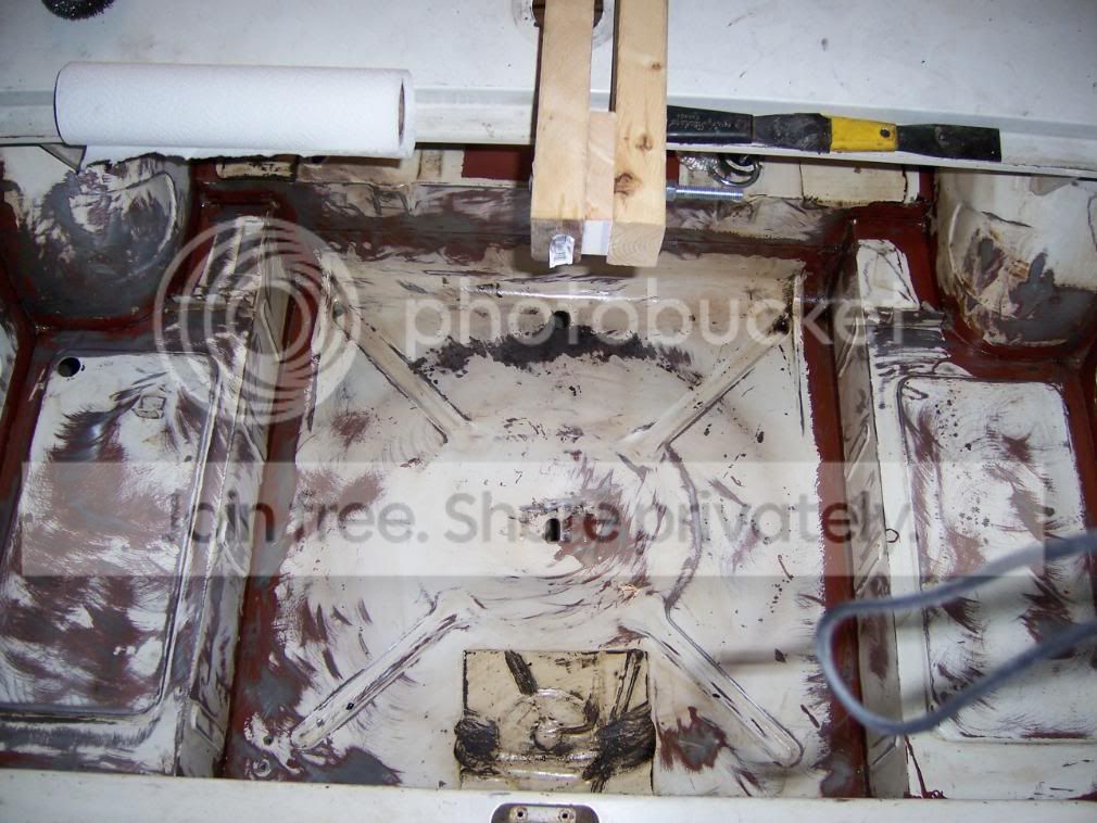

Try brake cleaner. Makes a mess but is does come off after you let it soak and rub it off. You will need to apply, clean and reapply though.

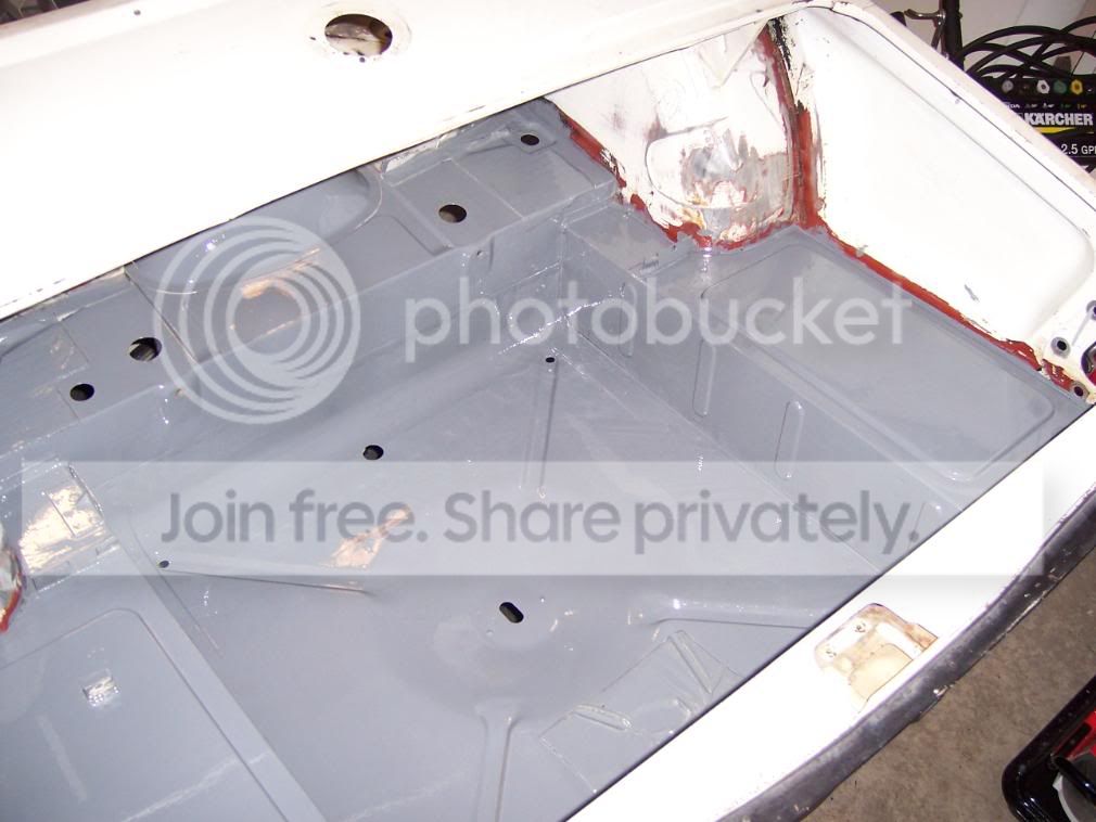

M_Pied_Lourd said:Hi Don,...POR15 can be difficult to put anything on top of other than POR15 products. You need to buy either their Tie Coat Primer or their self etching primer and follow the directions carefully.
Hope that this make sense.
