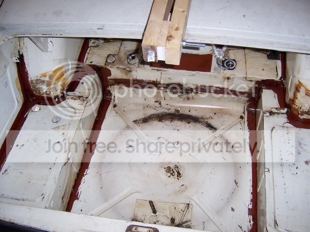

Here is mine after taking all the seam sealer out.

Here is some ugly stuff, the pads under the tank
Center
Right
Tarboard Don. Sound deadner like an ashphalt shingle?

Dave I noticed in your pic that the middle of the tank area has red lead in it.
Mine didn't
Just went out to the garage and had a look. Mine has it too - both sides under the tank and still intact. The rear of my car is way up on jack stands and hard to get at the trunk but it feels like the tank may just rest lightly on these pads, probably along with the other padding crap that was attached to the bottom of the tank itself. Sound and vibration damping as somebody already said? I had my tank redone years ago so no water-holding pads left on it. I'll have another look tomorrow.
