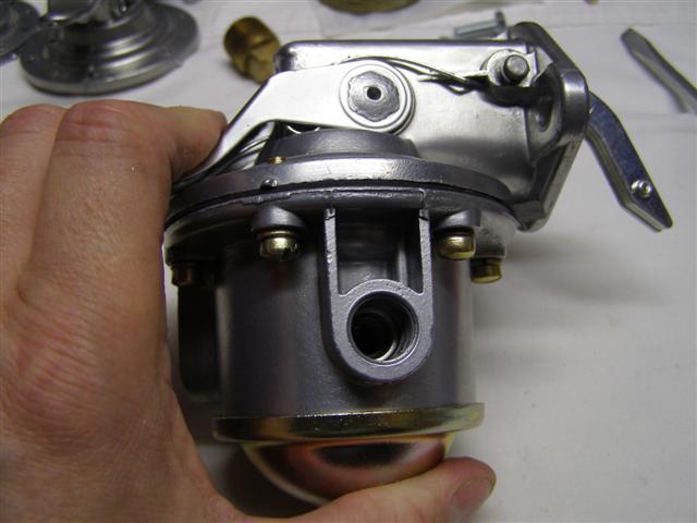

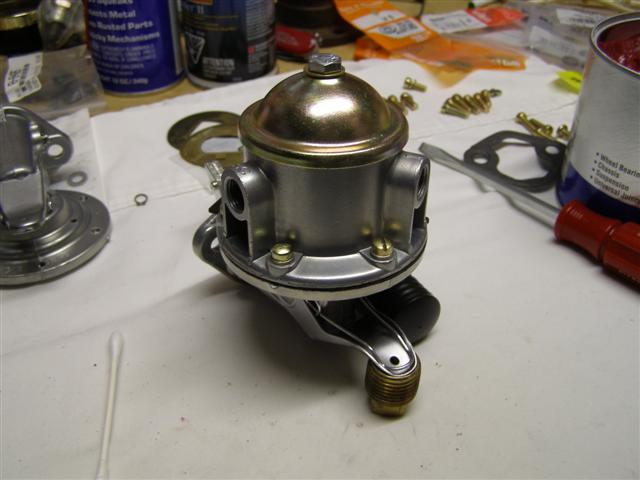

<div class="ubbcode-block"><div class="ubbcode-header">Quote:] Dale, that is your problem. Brosky rebuilt your pump! Should be as I stated above. Don't question me!![/QUOTE]
Hey, what's up with the questioning of my finely rebuilt fuel pumps. And here's a few pics to prove the inlet & outlet sizes.
