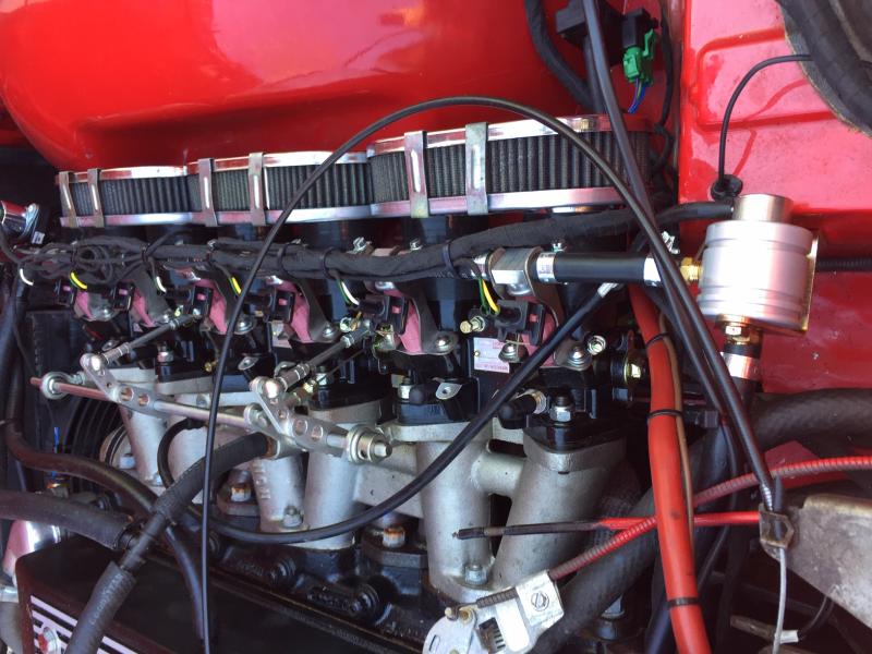

I had retired my Stroms years ago and already had the cannon manifold for the webers so just elected to to buy Webcon throttle bodies. the guys system alows you to use your stroms as throttle bodies or any carb set up for the throttle body, you just have to remove the dampers or the internals and the injectors then are mounted on the air filters( after you drill a hole thru the air filter. or your can have your intake manifold machined to accept the injectjors, The more I drive the car the happier I get, best part is when you turn the Key my TR6 Immediately starts up! I forgot to mention to the guy that I had an electric fan and with one extra wire running from the relay to the ECM, now the computer tells the fan when to come on and turn off and it also increases the RPM when the fan come on so when at Idle so the car doesnt stall on me

here is a photo

here is a photo
Thank you for getting back with me on this. It looks like a nice clean install. Since I only saw two drop links down to the throttle bodies from the pivot rod, am I am correct in thinking that the forward body works as a master, has the throttle position switch and also slaves the middle body with the rear body being linked by the rear drop link?

Yes correct, Front Throttle body has the TPS and the middle TB is connect via a connecting arm from the front TB and the rear is connect by the drop link
