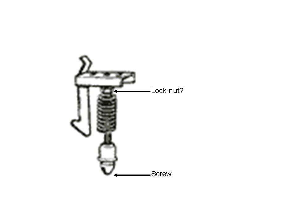

Kevin- If I remember correctly you should be able to adjust the spring tension on the plunger. There is a screw at the very end where the spring is and I think if you turn it in it will increase the tension.
Check the Bently Manual.
edit: Kevin- I also think there is a lock-nut at the top that will have to loosened and then tightened again after you use the adjusting screw to increase the tension. I will have a look at my car in the morning.
Kevin- OK, I just went out to the garage and checked mine... there definitely is a lock-nut at the top of the spring that needs to be loosened before you can add tension.
It will slightly increase the tension of the spring, but will also change the latching depth and can make the hood difficult shut and open. If you press down on the hood when it is latched and there is a little bit of loose movement, you can probably tighten it a little bit. If it is fairly firm, don't mess with it.
The catch plate and the hood fastener or pin have to line up just right or they will bind and the hood will not pop up. If this happens and your sure the they have released you can pull on the front edge of the hood and it should pop up. You can adjust the spring but don't get it to tight you may put a dent in the hood when you push it closed with your hand. Have you had the the plate or the pin off or loose from the car recently? It may be out of adjustment. You may need to see if the two parts align. I don't think you need a new spring unless it broke.
