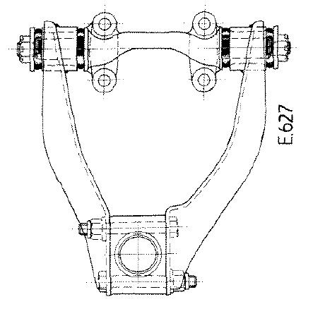

PS, here's a diagram from the TR4A page in the workshop manual

A couple of the TR restoration books point out that the diagram shown in the Workshop manual is wrong and that the "bulge" in the fulcrum pin should be mounted towards the spring tower, even though that looks incorrect. My car had them mounted the wrong way around (probably by me!) after the rebuild and had excessive negative camber. Swapping the top wishbones complete with pins from one side to the other cured the problem. Neil Revington has the full picture here:-
www.revingtontr.com/TR4A-6%20Upper%20Fulcrums.doc
It is not a big job to swap them. Support the lower wishbones on stands and undo 6 bolts per side - 4 on the fulcrum and 2 on the upper ball joint - and change them over. You don't have to disturb springs or brakes etc. Just make sure that you get the 2 bolts holding the ball joint correct. There is a difference. One faces forward and the other backwards.

The diagram attached by Randall is the one I was talking about - it could hardly be more clear, and it is definitely for a TR4A. Obviously it could have been drawn wrongly, BUT the PHOTOS in the manual also show this same mounting (curve towards the engine). So did Triumph change their minds???
Either way, having spent all night thinking about it (!!! how sad is that? !!!) I realised that turning the fulcrum pins round (moving the curve to be towards the wheel) would in fact decrease the negative camber and so improve my position, thank you.
