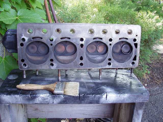

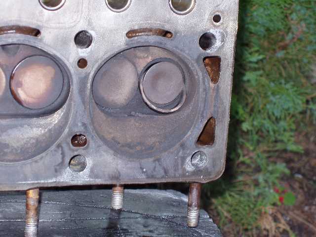

Head is off and much as expected... not horrible but #3 is a bit more recessed than its brothers. Off to the machine shop for hardened seats and whatever else is needed.
