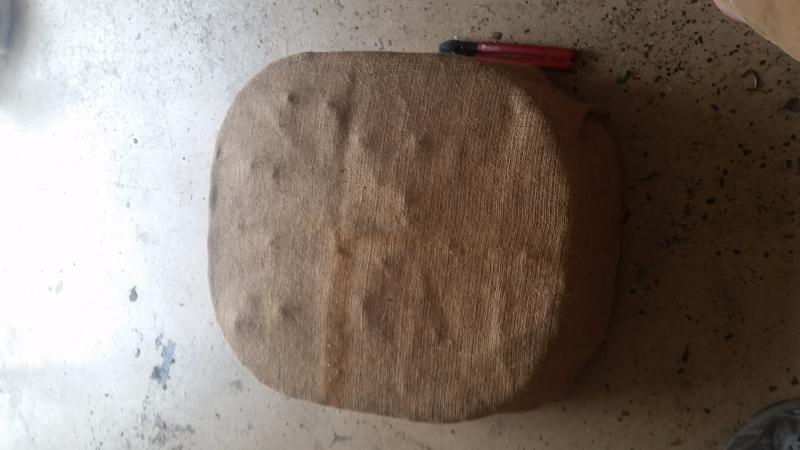

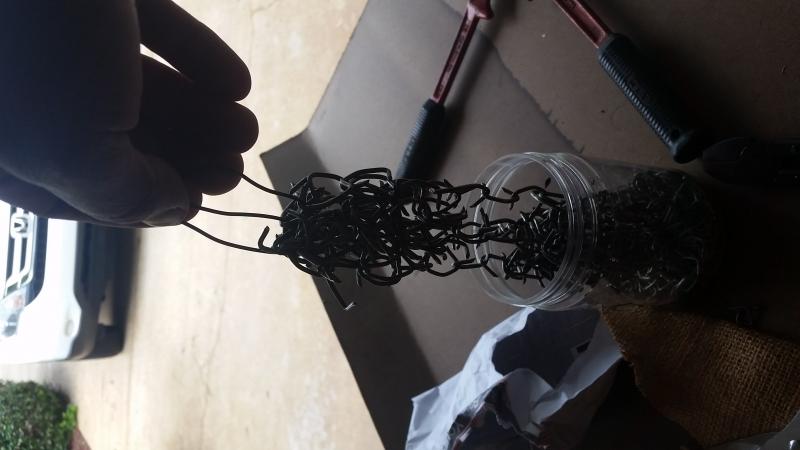

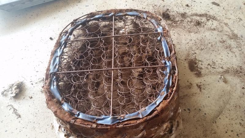

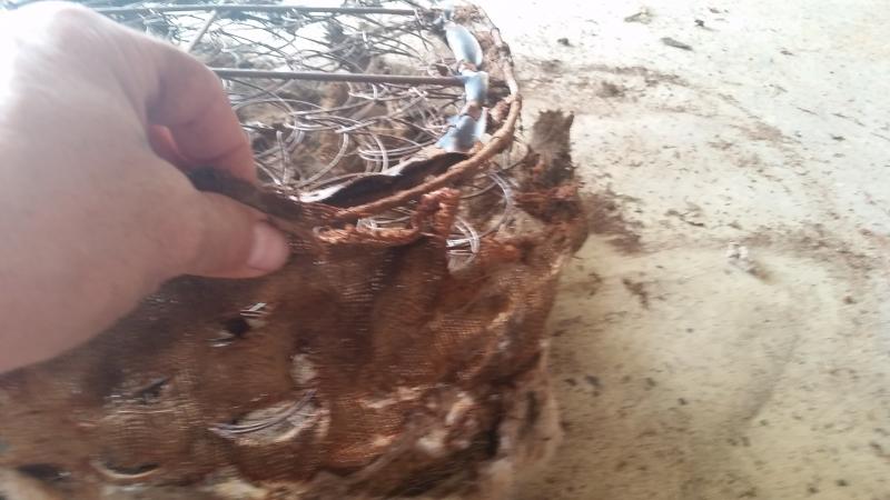

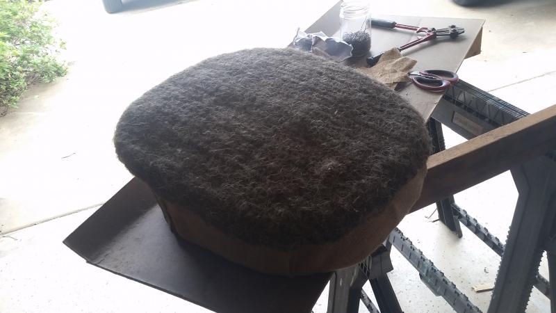

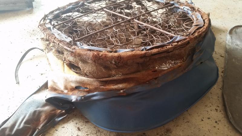

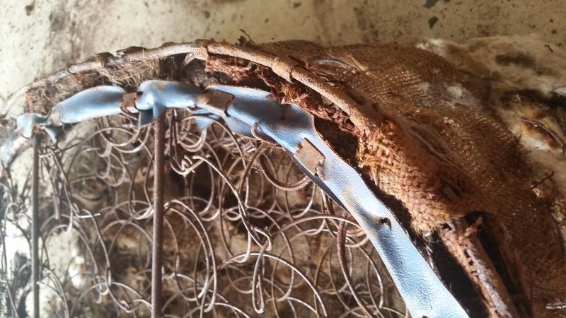

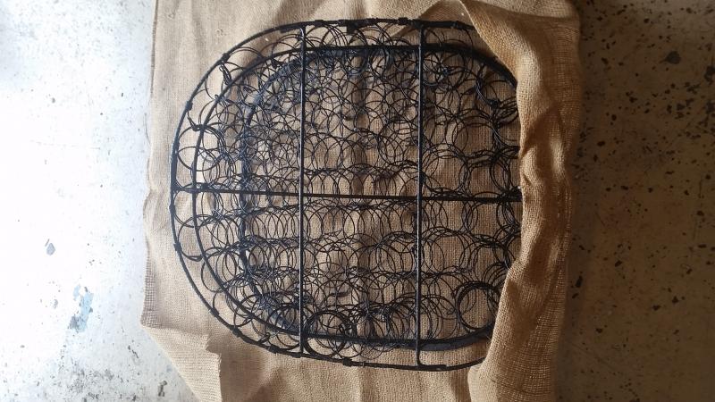

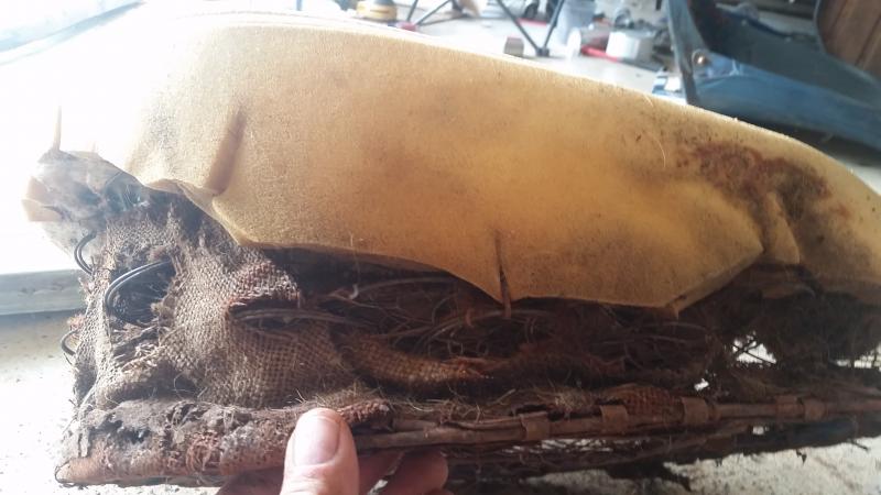

I'll document mine within the month. Trying to get an estimate from Jonathon Skinner on my interior delivery. In the mean time, these pics may help...
Note that the burlap is stitched to the spring frame to hold it in place...otherwise it will slip over time. Do not use hog rings here, as they will eventually wear through the cover.
The burlap goes completely around the springs, to protect the cover from the wires, that will wear through if left exposed to the covering. It gets hog-ringed to the underside of the frame. The horse hair goes a few inches over the edge of the springs, and also gets stitched in place. The foam in the picture is NOT original. In place of the foam, cotton batting goes over the horse hair. It will stick fine, so does not have to be stitched.
The cover gets positioned on the top, and folded over the sides.
Ensure the factory edging is centered in the back.
This is a poor job...but you get the idea. The sides get stretched slightly over the bottom edges of the frame, and then hog ringed to the inside. You should have some selvage, but not this much.
Hope this gets you started....like I said, a couple weeks I'll be diving in.

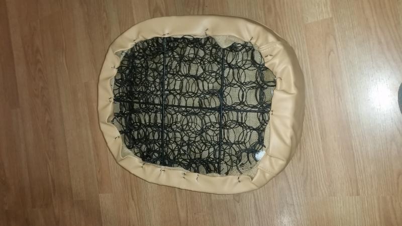

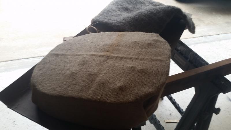

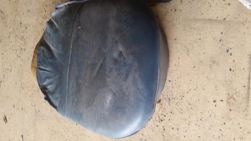

I took the big step and went for it. For some unknown reason I was not able to attach two pictures showing the final result. I used the Moss Seat padding kit and covers. Thanks for all the help offered.
