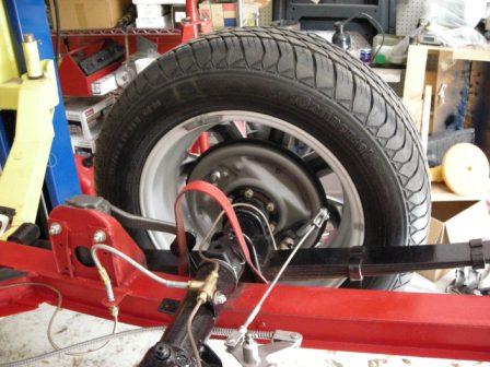

Don's pictures are correct. The wheel cylinders should be level with the bottom surface of the springs at the back edge of the u bolt mounting plate on both sides of the car. The emergency brake rods will be parallel with the ground and not bowed. If you need to take pictures of a car you can come by my house in Chantilly or I can send you some.
It isn't right. I just went out in the garage and looked. The E-brake has to be lower. The e-brake lever and cyl.inlet should pretty much split the leaf spring. The inlet just below, and the lever just above. As per Don's original photo.
Had to think about it ... if the backing plates were on the wrong side, the e-brake levers would point the wrong way. They don't, so the plates are on the correct sides, just clocked wrong.
All fixed and brake cables are now parallel to the ground in the correct position. The cables had about an inch or so of slack after moving to the correct position so I cut off the adjustment bolt a bit on each cable so the slack is gone but the cables are not tight - hope that was OK to do. Couldn't see how the handbrake could get enough throw to activate the brakes otherwise. My cables now looks exactly like Stigs.
