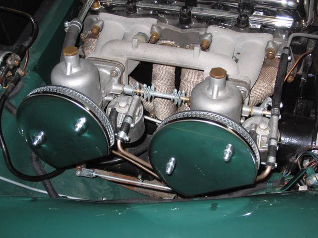

The TR3A I finished in June came with exhaust headers and the owner wanted to keep them on the car. Because these exhaust headers extend out and then curve down, the TR3A intake manifold had been removed and replaced with a longer manifold from a TR4. After re-mounting the carbs from the TR3A, there was no space for the original air filters. So we bought some (see attachment) and modified the hole and mounting nut locations so they would fit. The last thing we did before shipping it back to the owner was to install these fabricated air filters. The owner was running the car in September and thinks the small opening for the air might be causing air starvation and he says he can't get it to run very well. Before we had put on the filters, it went like a bomb, so maybe he has to investigate it more next spring.

Hey Don. How about building a custom air box with a remote filter. That way you can increase the air chamber size and move your filter up front.
The Triumph Register of Southern California website has a tech article about using the H6 carb with the longer 4A manifold. If you can score a set of HS's, you may have enough room for larger aircleaner.

Mark & Bill - The problem is no longer mine, but I'm always willing to help out the owner of that TR3A if I can. He is 360 miles from where I am. He could just remove the air filters. That's the way it was when it came to me 8 years ago this week for the full restoration. When I restored it, I felt it should have some sort of filter set-up and that's how I did it.
As for Capt Roy, my idea was to let him know about a possible problem if he had not yet forseen it yet.

I have the HS6 carbs off a TR4A along with the manifold. I'm going to call Ted at TSI tomorrow to see what K&Ns I can use. I know someone used crossland filters but I'm not sure of the quality as the are only 13.00 each from Moss. Heck(or another word), they may let a stone through! If anyone has a TR3A with TR4A head, long flow manifold and HS6 carbs please let me know what you came up with!

We're running K&Ns on the 3A with HS6 on a TR3 manifold. The K&Ns are the 1-3/4"H filters and there is only 1/2" clearance to the inner fender at the front carb.
Crosslands are just foam and K&Ns would be my choice if they fit.
