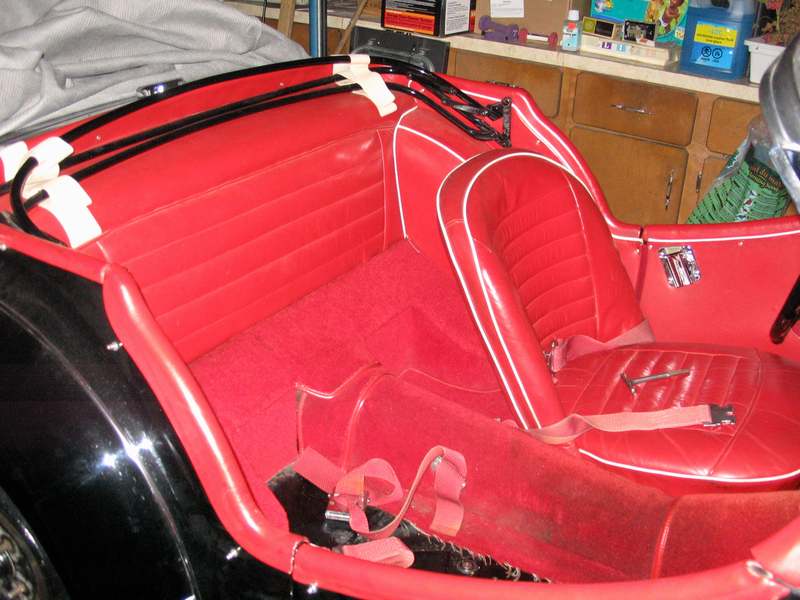

Whe I bought my TR3A brand new in May 1958, it came with red vinyl. But I had no tonneau cover and with the sunshine, it soon went orangy-red. When I did my restoration, the correct red vinyl (original) was no longer available so I ordered the entire interior made in leather. Hides can be dyed any colour you want and that's what I wanted. An interior colour that was like the original and that some parts (like the vinyl) wouldn't fade.
It's still all one colour as it was 21 years ago when I installed it.

Thanks Elliot,
Thats the color combination I am planning on,maybe the darker red.
Your interior looks great,especially the drivers seat after all those miles and years.
