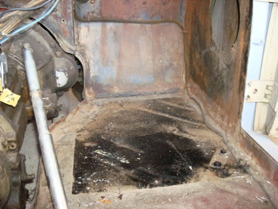

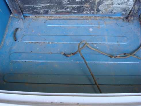

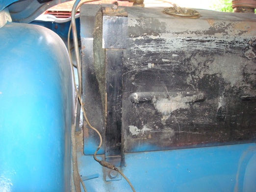

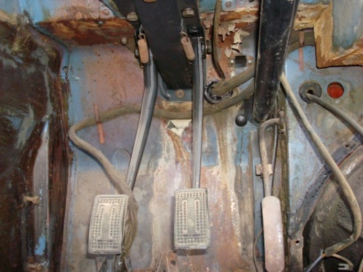

My understanding is:
-- floor of the boot, righthand side, will be sort of hidden under the mat
-- along the passenger door (sill) under the carpet
You may find metal tabs one or both places for holding it in place.
:iagree: Being under the carpet was kind of hard on the original cloth outer wrap, so I added some sleeving through the passenger compartment on my TR3A.
hope this helps

Keith, your pictures couldn't have been more timely for me, and I' sure others. I'm putting my harness in starting today and while I had some vague idea of how it goes the pictures are immensly helpful.
Thanks, Tinkerman
Ditto for me.
The pics were a big help. And, I like the idea of using a sleeve for the portion of cloth harness.
