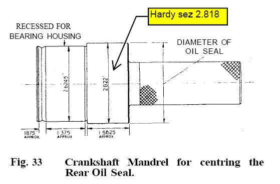

Joe Alexander sells one. It's not on his site, but I've seen it somewhere. He's also selling an improved rear seal that requires no crank machining. They modify a stock seal somehow to accept a split rubber seal. I'd bet a dollar that Joe's mandrel works. If anyone would know that he factory spec. is wrong, he would.
Joe's tool is made to the same dimensions that Art described.

And the BPNW tool looks like Joe's so I'm assuming he's marketing it similar to other stuff he makes. My micrometer skills are a little rough, but the smaller diameter I think I'm getting 2.6245 as shown, the larger diameter to me seems closer to 2.815, even smaller than Hardy's recommendation - but that just may be my lack of micrometer skills.
