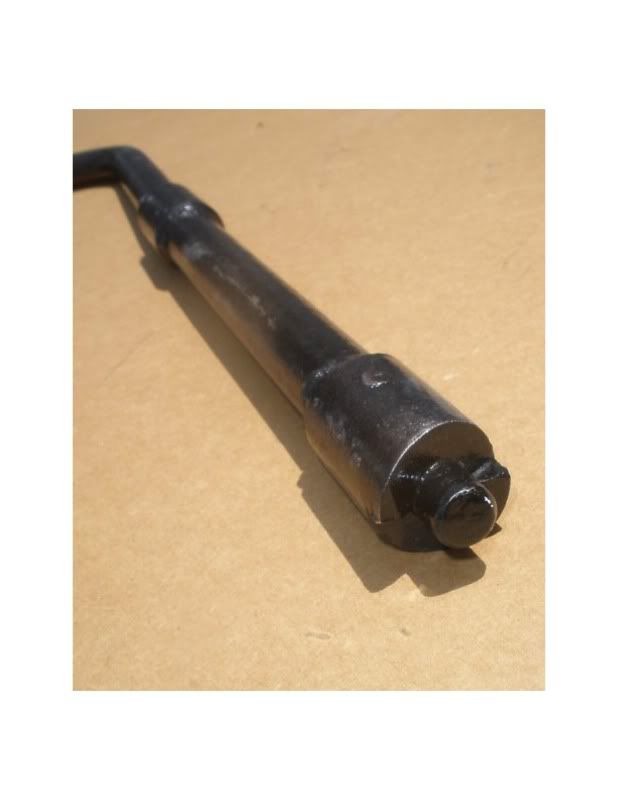

Below is the tip of the one I just ordered on eBay. The seller will take it back if it doesn't fit. What do you guys think? Am I golden?
Geo Hahn said:
Be aware that there are different cranks -- at least 3 that I know of -- for TR2s, TR3As and early TR4s. The difference is the placement of the boss that rides in the cast metal guide.
Had to go look for the part numbers.
TR2/TR3 107863 (1 to 22013)
TR3A/3B 118366 (22014 on)
TR4 131818 (Needs radiator 134456 with starting handle hole)
Interestingly the Roadster Factory lists the TR4 one as current for only $23.95. I wonder if that's a mistake in their database.
