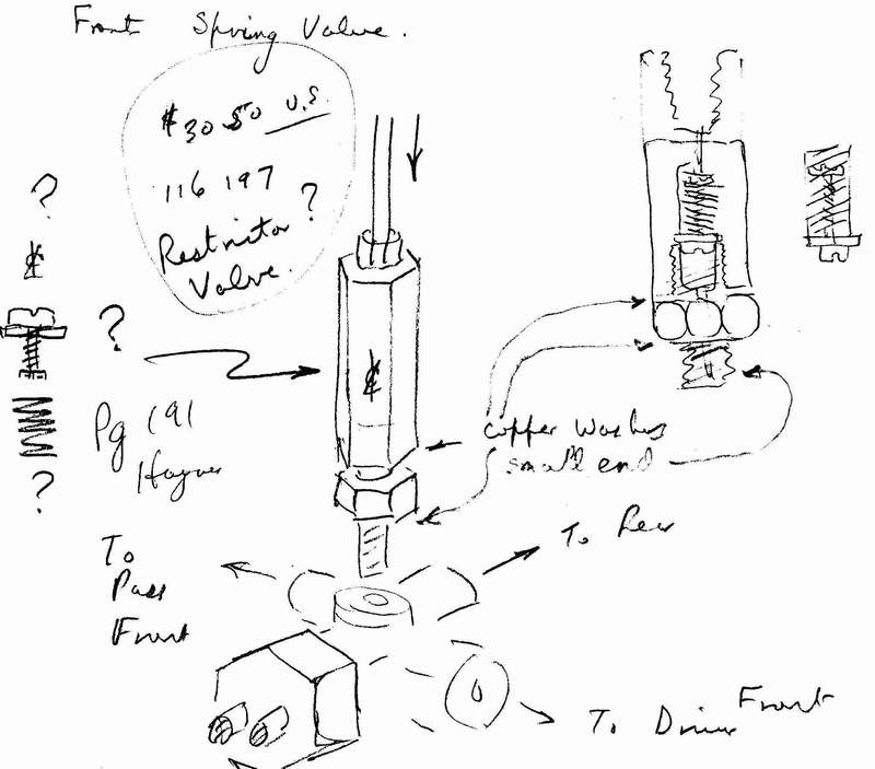

my Tr3 came with new brake lines on chassis,looking like the only new line I needed to run was from the master cylinder to the installed 4way connector.
However with 4way in right front,and 3way tee in back,I see no place for brakelight switch.Moss shows 5 way ,which I guess is the one I need if I dont add an extra tee.
Also It looks like the MC line goes into the top of the restrictor?
Also is there a diagram of the restrictor showing internals and direction of installation,as I am concerned if this restrictor is installed correctly.
Thanks
Tom
Here is a sketch of mine from 1987.

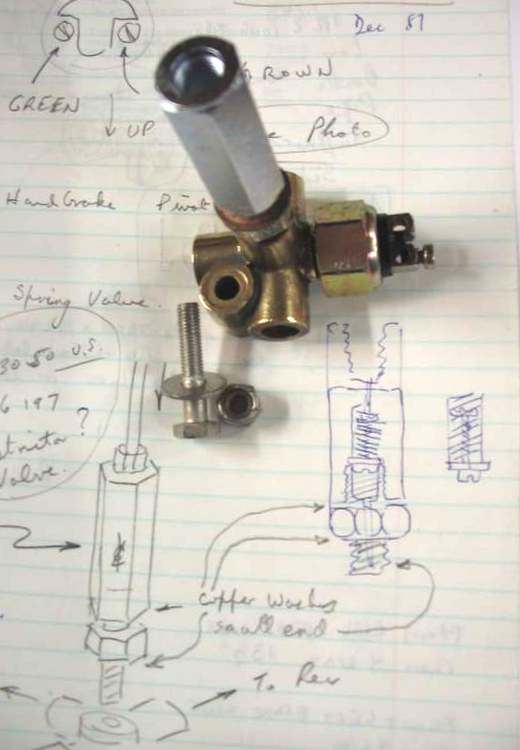

Here is a photo. The long end is straight up and the hydraulic brake switch faces towards the front of your TR.

Tom, the 4 way connector on the chassis was used on TR2/early TR3 front drum braked cars, which didn't have a restrictor valve.
Front disc braked late TR3/3A cars need a 5 way connector, which has a top female thread for the restrictor valve. The RV fits vertically with the male thread end down into the connector. Then the brake line from the master cylinder goes into the top female thread of the RV.
Repop stop light switches don't seem to last long, so an option is to plug the hole in the connector and mount a modern stop light switch on the pedal box.
The RV should be taken apart and cleaned. There is a cross section view of the internals on page 191 of the Haynes TR2-4A Triumph Owners Workshop Manual, if you have one.
Regards,
Viv.

Thanks for info, this is exactly what I was looking for.I have taken the valve apart and it was cleaned and after looking at posted pics appears to be in the right position.
