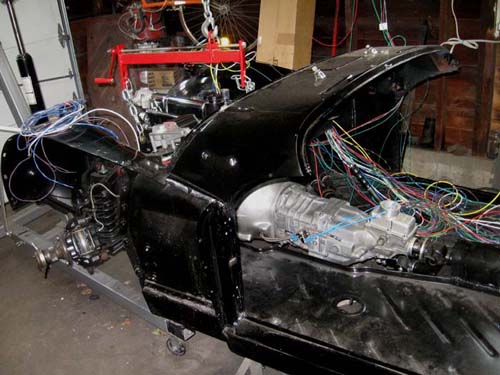

Of course, the other alternative is the wiring harness/Power Block assembly from Advance Auto Wire. This way you get to spend twice as much money and six times the amount of time installing it. :laugh:
I got it for my TR3, and glad that I did. Although it was a ton of work, the end result is superb. Below is a pic during installation. :sick:
Edit: Better make that <span style="font-weight: bold">TEN </span> times the amount of time to install...probably 30-40 hours!
