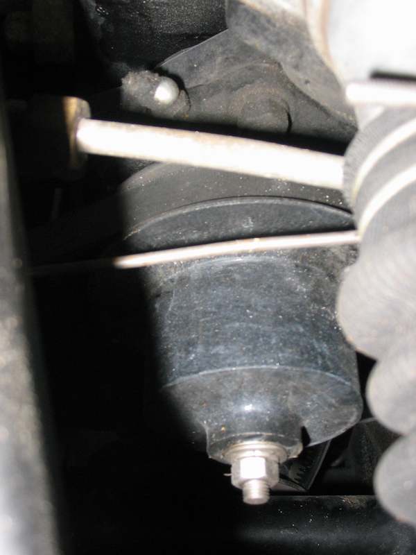

Don Elliott
As long as I can remember (52 years for my 1958 TR3A), the pulley and pump have always been black. Never had any comments from TRA judges as to it being black - or any discussions about any other colour.
