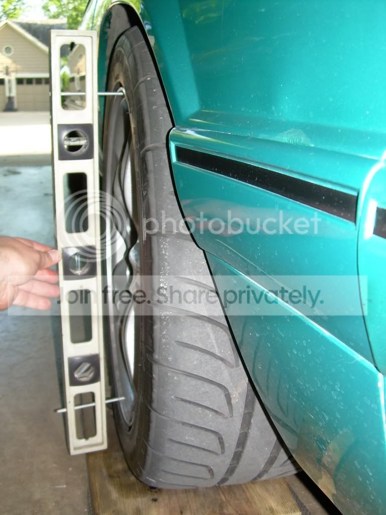

Here's another approach. On a Mustang forum, saw and liked this homemade approach to checking toe (there's another shelf bracket mounted to the board on the other side of the vehicle) Thought the use of an easily modified level for checking camber was neat too.

His description was to measure at the wheel's back edge, then move the board to the front of the tire and place the tip of the shelf bracket on front edge of the wheel. The measured difference is the amount of toe in/out. He's also placed small squares of plywood under the tires to make any tie rod adjustments easier.
Don't quite understand that bit.
Cheers!
so the tires will move freely when adjusting in/out, the plywood acts as a swivel pt
