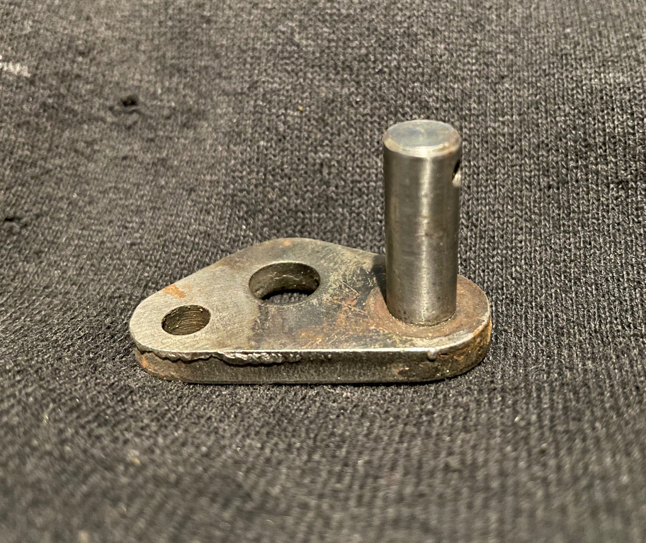

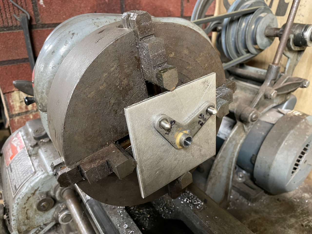

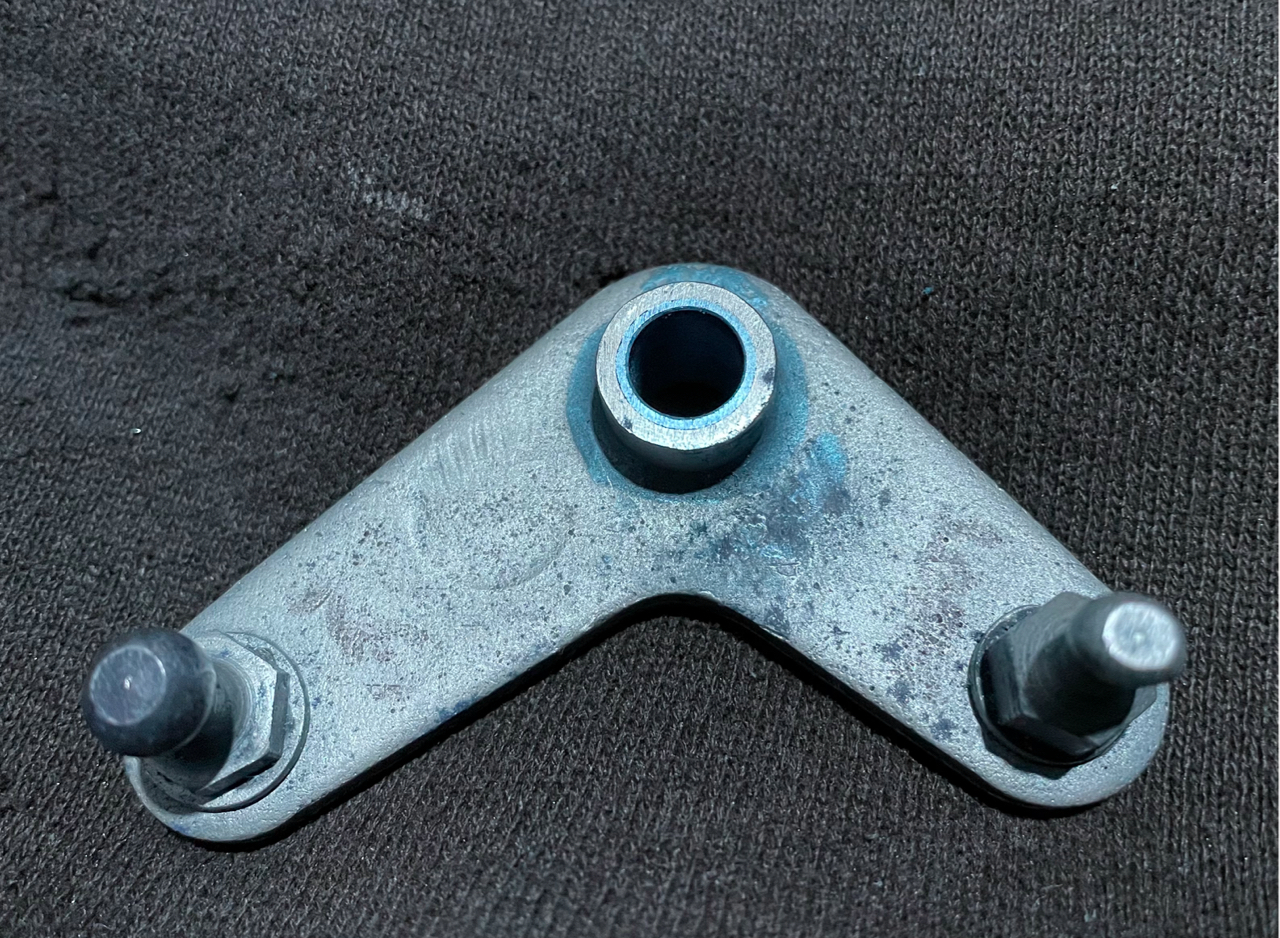

I had put this project off till I got an old Atlas lathe from the shop I worked in during high school. Yes some 40 years later I had the lathe that I had played with many years ago. The lathe has had many years of abuse but I felt it would suit my needs. I decided after some precise measurements it would be better to machine a new pin to match the original after I removed it. Heating the joint to melt the silver solder and a gentle twist the pin was out and could be reproduced, yes on my old lathe. The new pin was silver soldered back in the mounting plate including a detail that would only matter to me. The cotter pin hole is orientated the same as the original. I doubt any two were ever done the same but a fun detail to take note of. Now the pin is back to original size, the next task is to put a bronze bushing in the bell crank. I located a 5/16 OD 1/4 ID bushing at a local industrial supply store. The original pin size measured above the cotter pin where there is no wear was a few thousands under 1/4. Knowing this I could know how much to machine the bell crank undersize so when I pressed the bushing in it would shrink the ID so I was able to achieve an exact .001 clearance Pin to bushing and now have a buttery smooth bell crank. I added shim washers above and below so there is minor room for the bell crank to move up and down on the shaft. This was a fun project to test the old lathe out. I know this is way over kill but it keeps me interested in my project as I still have a long way to go. Frank

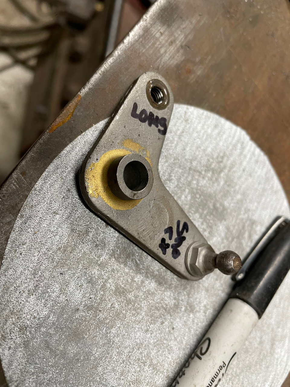

Nice repair. I punched out some brass washers to take up any slack and give a good wear surface for the bell crank.
I had considered a bronze bush and may do that in the next batch I make. Did you use Bronze or Oilite?
David
Hi David,Your new bell cranks look great. I actually used an oilite bushing. I don’t believe there will be enough heat in the bell crank to hurt the oilite bushing. One thing I will start looking for is replacement pins that the linkage snap over. Mine have wear spots in them and need replacing. Frank

I have to apologize about some details that I am mistaken about. I went off my memory rather than look back at my notes. I used a 5/16" x 1/2" x 5/8" bronze bushing. The plastic bag that the bushing came in list it as
Bronze bushing "FEB" SS-10-16-10. This is a SAE 841 sintered bronze oil impregnated bushing. I used a 3/8" 4 flute end mill to bore the bell crank, this makes for a very round hole for the bushing. I turned a mandrel to hold the bushing so I could turn the OD of the bushing. The pin that the bushing rotates on has a diameter of .310" , same as the original. The ID of the bushing is roughly .003" to large so I turned the OD of the bushing to .377" so it has a .002" press fit and shrinks the ID of the bushing to leave .001" clearance.The height is roughly 9/16 and this was accomplished by filing the bushing after it was pressed in. I will be truthful that I did not get this fit on the first try. It took 2 tries because I then knew how the bushing would shrink. Sorry to bore you with the math to get the fit I was looking for. I did this exercise just to see if the old lathe could still hold tight tolerances. It can but it is slow, no digital readouts mostly you have to sneak up on the measurement you are shooting for. Frank

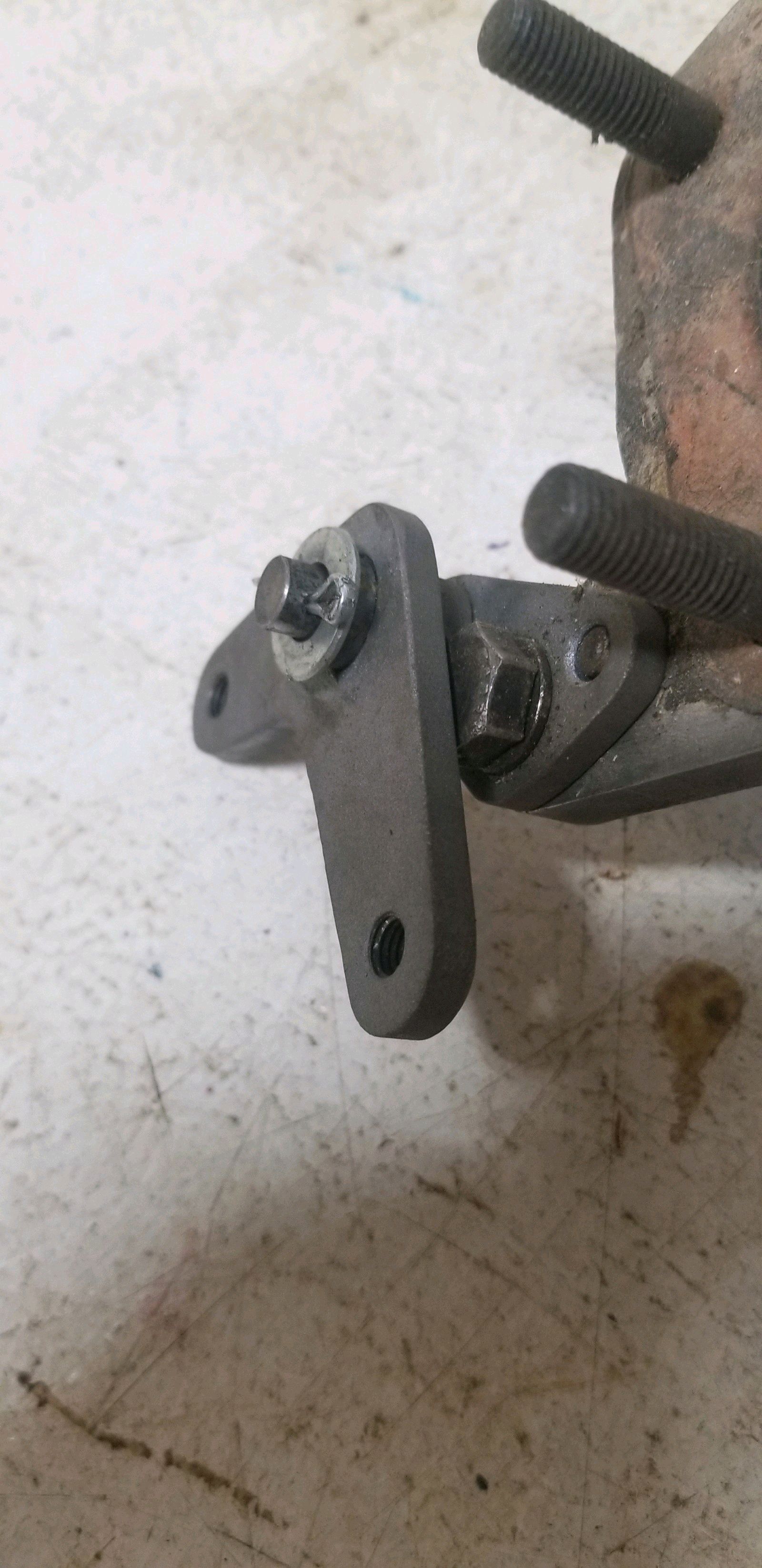

I think you may have your bellcrank mounted backwards. I think the wider boss should be on the outside away from the engine. That puts the longer leg at 6.00 clock and the shorter leg at 2.30.
David
Hi David.
Per your advice I tried flipping over the crank as you suggested. I know why I did it. It ran into the head of pivot mounting bolt when I did it as suggested. Is that bolt special with a thinner head? I ground down the head of the bolt for more clearance and mounted with the thin boss to the engine and the little arm towards the radiator. It still wobbles a bit even with some washers but seems better than before.
Rich
My apologies.
Looks like I had a senior moment.

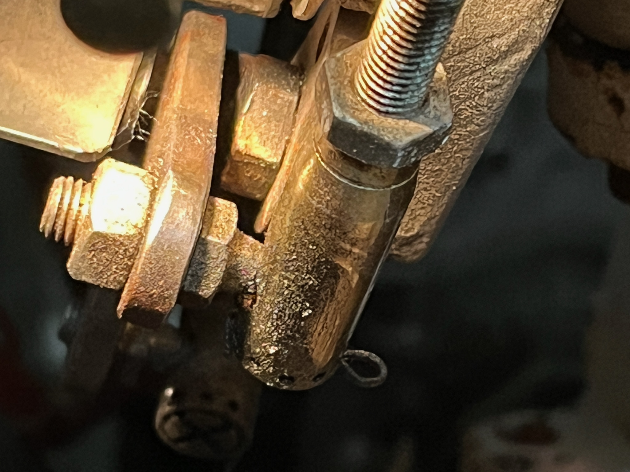

At some point I managed to flip my assemblies over. Looking at the linkage on my TR the long leg is horizontal and short is vertical with the thicker boss towards the manifold. That will allow a standard bolt head to clear.
The heat shield makes it very difficult to see so I mounted one to a spare manifold.
David
Sheize!!! I shaved it down already. No real harm just a thinner bolt head. Well it all fits. I can mount up my spare the correct way with the long arm to 3 o’clock. I’ve played with a thin wrap of steel foil to shim the post and that seems to work. … until it doesn’t. But it won’t be any worse than the current play.
