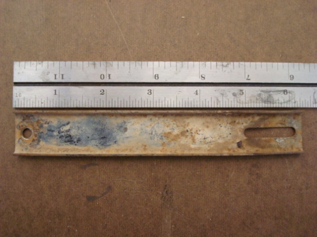

Can anybody ID this part? It came with a bunch of TR3 parts I got with the car I'm restoring. At first I was thinking rear fender brace, but that's not it.

Don't recall anything like your picture on TS13571L.
Jim - You may be close. I'll suggest that it may be the bracket that goes under the dash to support the S-T ashtray which became a standard item on all very late TR3As after quite a high Comm. No.
I'll be cleaning up some other black parts so I will clean this one up also, and maybe find a home for it. As for it being part of the ashtray I don't think so. To much road grime on it, looks like something that was exposed to the weather.

That is a kinda rare part. It is the piece that goes down under the nose and pulls the nose back to the frame. It is needed mostly on the smallmouth because the nose hits the bumber if it is not pulled back.

Steve I think you are 100% correct. There is a small bracket on the 7/8" cross tube on the front of the frame, and an area on the apron in the center that fits the part in question. I will confirm this when I put the body on the chassis in a couple weeks. Thanks a ton.
