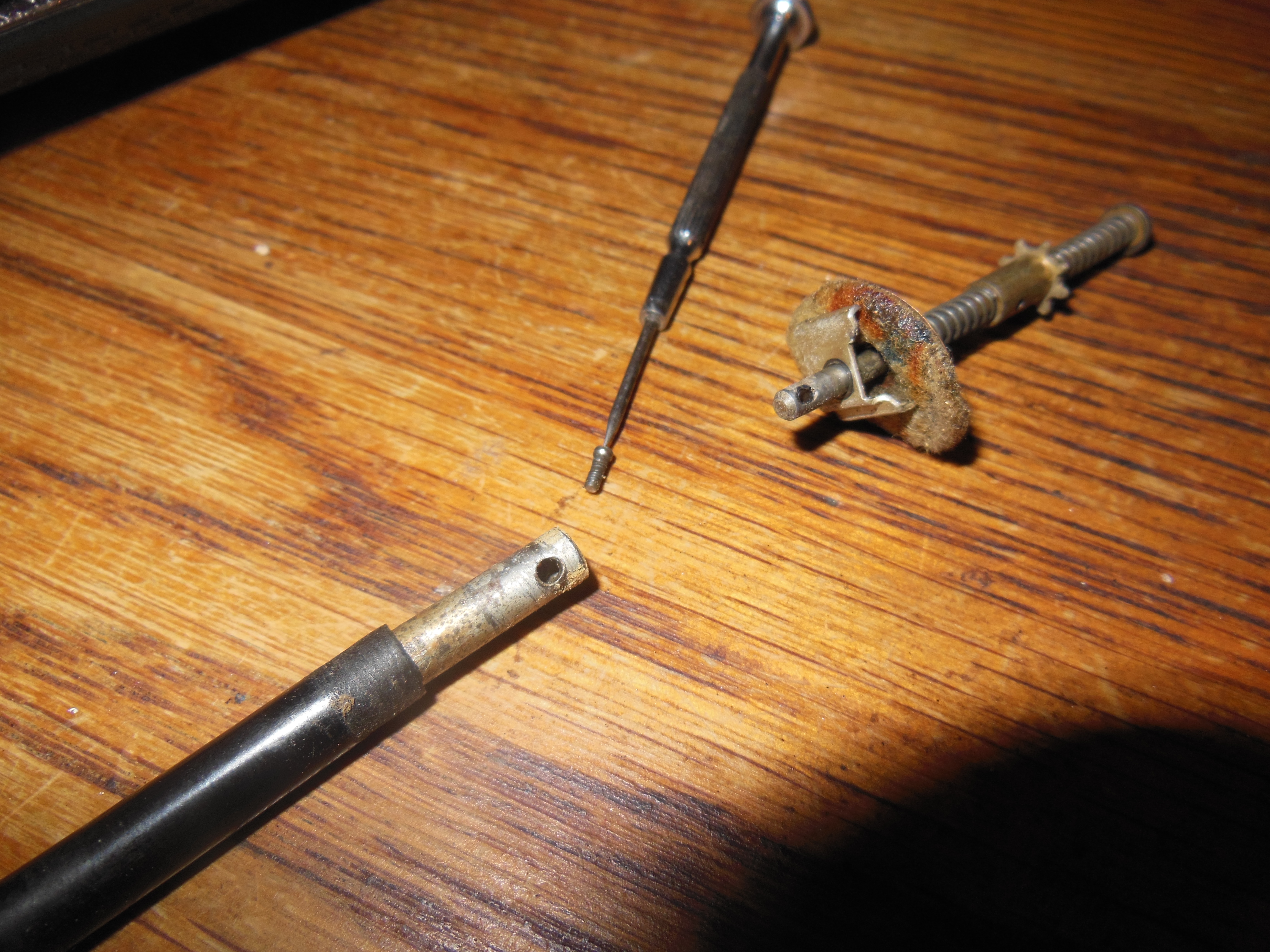

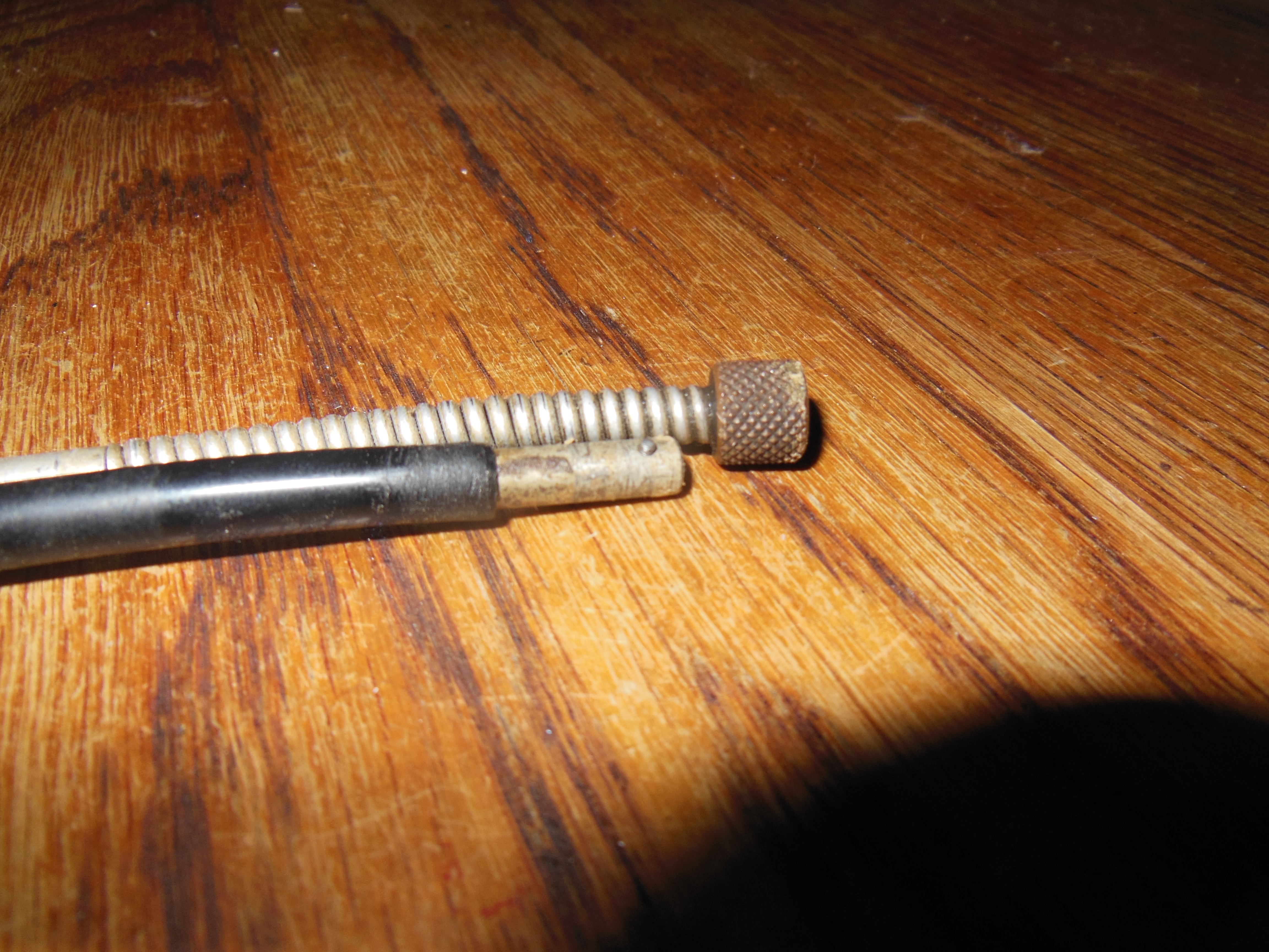

The end extension piece that is not shown has the threads for the little screw. If you find the knurled end piece you are missing, you can probably make a rod because the very small screw passes through the hole in the rod to the end piece. The speedo looks like an early one 1958 or earlier with the cast pot metal maybe aluminum housing. The odometer rod would need to be early also to work, but again you can make that. I would concentrate on getting the very end piece, an early one. I saw one on eBay a while back. You might be able to reset it with some small needle nose.

Here are the pieces you need. The screw is very small.
steve
