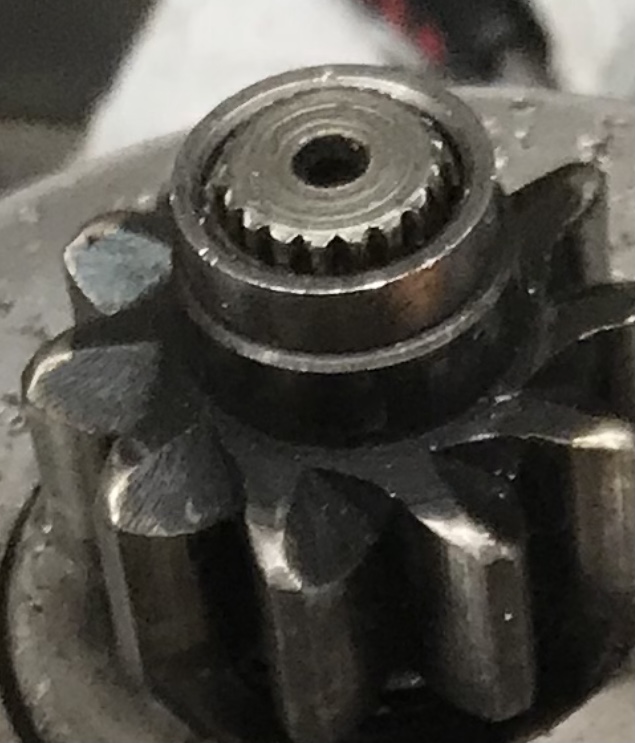

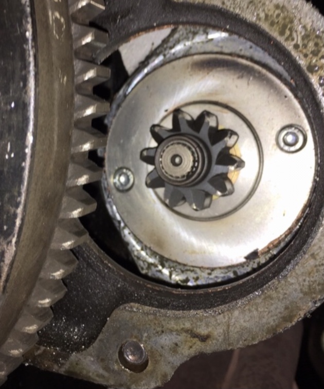

This is my powerlite hi torque starter on my 1959 post TS 61*** car bolt on ring.
If it helps
But I see that revington say that the press on ring uses a 9 tooth starter

Thanks Hamish I could not find that information. The one I got on Craigslist has 10 teeth. My bet it is for a later 3 or 4. I wonder if I could just put the 9 teeth gear on mine and have back up. Any idea where I could get a 9 tooth or if gear comes off easily with a puller?

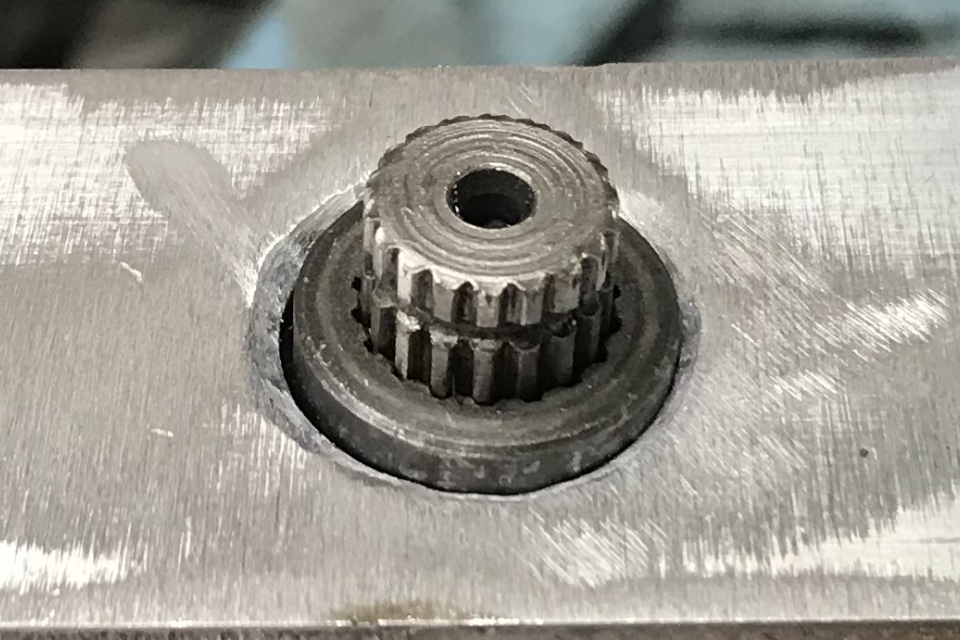

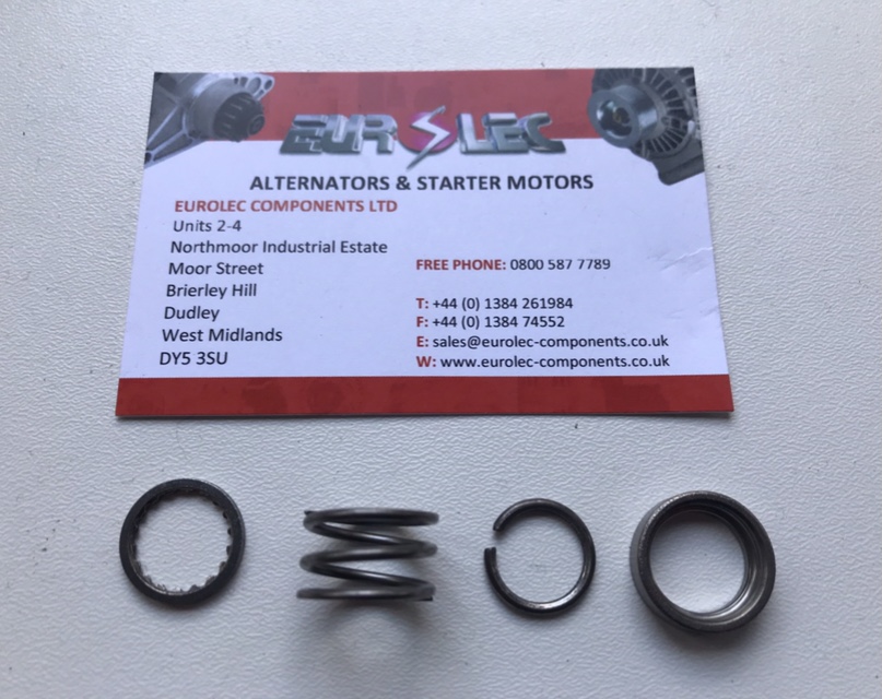

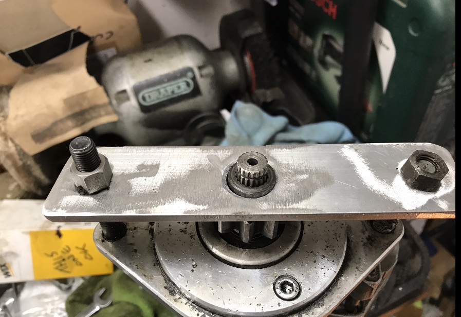

I can only talk about my powerlite type.
I had a securing clip break and they sent me a kit.
I made a plate to make the job easier
An alternate gear should be available from your starter manufacturer
Don’t use a puller hold the shaft out and push back the cog on the spring and you should see the retaining clips and collars
