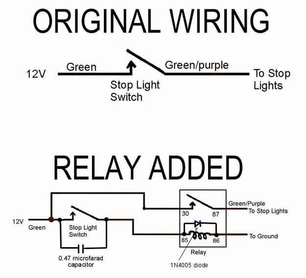

Since I last add to this thread I have added a relay to the electric circuit for the brake lights. It has greatly extended the life of the switch. You should not lose much fluid changing the switch if work quickly, have the new one at hand reinstall as soon as the old one is out. David DuBois gets the credit for the electric engineering and here id description of how to do it:
Installing a Brake Light Switch Relay
The replacement brake light switches sold today are extremely light duty and don't hold up to the 3 amps drawn by the brake lights for very long before the contacts burn again (I have had them burn in just two weeks). Adding a relay to the brake light circuit will remove the heavy current from the brake light switch.
The relay to use is a general purpose 30 Amp automotive relay, sometimes known as a Bosch relay. They are available from Radio Shack and most auto parts stores. The relay can be mounted anywhere that is convenient. I mounted mine close to the original brake light switch, but it can just as well be mounted in the trunk (for the MGAs or MGBs), close to one of the tail light/brake light assemblies (if you do this, you will need to bring a source of 12 volts, other than the 12 volts that is switched by the brake light switch, back to where the relay is mounted). In the accompanying diagrams, I show a 0.47 microfarad capacitor across the contacts of the brake light switch and a diode across the coil of the relay. These are optional parts and can be left out if you wish. I added them as additional protection for the brake light switch. The capacitor is just soldered across the switch terminals. The diode can be soldered across terminals 85 and 86 of the relay. The advantage of the capacitor is that the capacitor acts as an arc suppressor and the diode collapses the field of the relay coil, eliminating any inductive surge across the brake light switch when it opens.
If you feel that you are electrically challenged, or just don’t want to fuss around putting the circuit together, I can supply you with a completely assembled circuit to fit you car. If you would like to purchase one of these relays and a capacitor, the price is $10.00USD (in July 2003). Send me an email to confirm current price, availability and shipping costs to your location. I also need to know the polarity of your car and if it has a hydraulically actuated switch or one that operates off of the brake pedal. Send a check or money order to:
David DuBois
1913 South Marine Dr.
Bremerton, WA 98312
Here is my circuit diagram for a positive grounded car:
If your car is negative ground, here is the circuit diagram for that configuration:
Hi Dave, that is a good idea.
I did something simular on my Opel GT, the ignition switch burns out from full power going through it, so we add a relay.
The diagram you did looks pretty simple.
