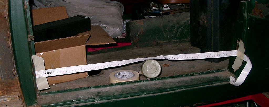

Maybe you should check the width of the door opening. This is my drivers side door, on a pre-60K car. The doors fit, latched and worked fine before I removed them. Two other doors I got off ebay (with better wooden inserts) fit exactly the same. The distance from the lower hinge screw hole, to the lower latch plate hole is 29 1/8".

Looking at your pictures, in particular the shot no. 8 that is looking straight down on the problem area, it could be that the PO that did the metal work may have assembled the panels with B-pillar a shade to far forward. Doesn't have to be off by much 1/4-3/8" is enough to cause the sort of alignment problems that your experiencing. As was mentioned, you may be able to solve the problem by a combination of removing some material from the back of the striker plate and possibly from the back of the hinges also. The worst case (last resort) you may need to cut out the recessed area where the striker attaches on the B-pillar and re-weld it back in a little further back.
Howdy Folks,
I`m not a "Body Guy" by no means but looking at the pics; I tend to agree with Rich. It appears that the "B" post is way too far forward. Whats all that "Missing" Metal directly behind the "B" pillar?
Also; It appears that the "Inside of the Door" is really pushed in! That striker is cocked over on an angle that just "Would`nt" allow for proper closing.
I`m going to forward this entire post to the "Restoration Gent" who is currently working on my `57TR3. The door gaps, closing the doors etc; Is working just fine. Perhaps He`ll have some input here for you.
Best Wishes,
Russ

That's good to hear that solves the problem. Since these are all essentially hand built cars with some variation in dimensions, TexasKnucklehead's post got me curious. I measured the distance on my car from the A-Post to the B-post on my car. The measurement on the passenger side is 29" while on the driver's side the measurement is 28 7/8"!
