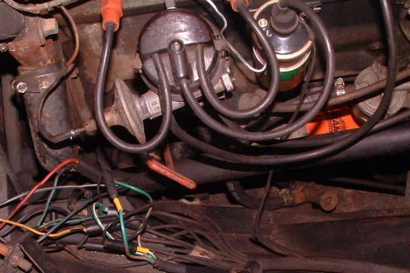

I found an old photo : The one that failed for me had a black top and gold case.
So much for color as an indicator... unless you can find one with the terra cotta top and Buck Rogers/Art Deco design.
That one is 42 years old and still working well (knock wood).
