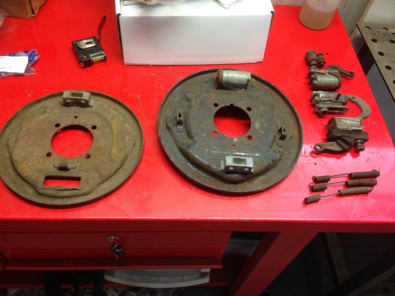

Hey Guys
im after a RH rear brake backing plate for TS8608. ive got the LH one, it looks to be a 10" type 80012/2LH is stamped on it.
Regards Cam Bayliss

Correct TR2 backing plate at the rear would be 9 inch. Better check if it is still the original Lockheed set up or if a later Girling rear end was used so you know what you need.

I probably have what ever size you need, let me know wether 9" or 10" and wether or not you can wait a week or two for me to cover it! $25 plus shipping or $35 all in. You would need to sand blast / clean up.

ive included a pic of what i have, i think its one 9"and one 10" both have LH stamped on them, so ill need a right hand one. If you have a 10" ill take it as ive only got 10"drums so that is more likely to be correct. Get back to me on a price, im on the other side of the planet to you in New Zealand so that shipping price my be different.
Thanks for the reply

Hey Dan thanks for replying, ive got TS8608, so has the later 10" rear lockheed setup

Thanks Cam - my mistake. Mine is TS 1911 so I thought they were all 9 inch!
Dan
P.S. I have a Lockheed differential on its way to me, with backing plates. If the backing plates are 10 inch, I won't need them and you are welcome to the rhs one. The diff is en route via ship to me so it may be a bit before I can see what backing plates it has.
