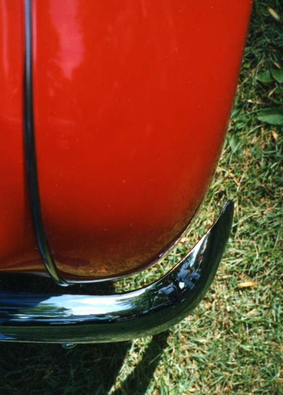

Here is how to tell if the bumper on your TR3A is original or not. Here is mine. It's the original one. The ends are rounded and curve back toward the fender.

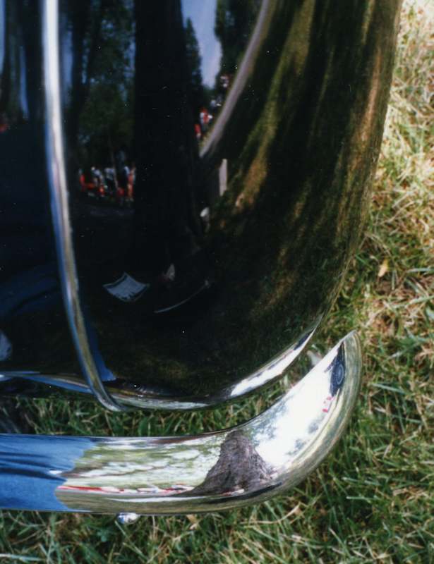

Because the repro bumpers were not made on the same presses, the end flares outwardly like wings instead of curving back. I've also seen some repro bumpers which have welding on the back-side in these curves.

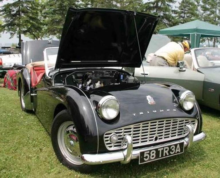

Adrio - I restored my 1958 TR3A from 1987 to 1990. The body was finished and painted by the end of 1989. Then I sent all the parts for chroming to the local chrome shop owned and run by a bunch of Harley guys. I cut a piece of of plywood (I still have it somewhere if you want it) of the profile of the front of my TR and gave this profile "gauge" to the chrome shop along with the bumper. They straightened the bumper (front end smash in 1963 Echo Rally had deformed it) to conform to this profile about 1/2" ahead of the bodywork and then they triple plated it. When I got it back I mounted it and across the center of the TR there is a gap of about 1/2" when you stand above the bumper and look straight down. Here is a photo from the Ottawa show where we met in 2005.

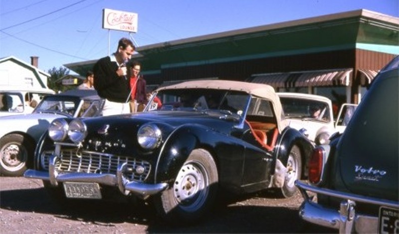

Here's how it had looked after the 2:00 AM smash on the Rouge River Road north of Hawkesbury in 1963. After this, I had the valance bodywork corrected and I used a 5 pound hammer to "straighten" the bumper till it was re-straightened correctly according to my profile gauge and re-chromed in 1990. YES FOLKS, - the same valance and bumper.
