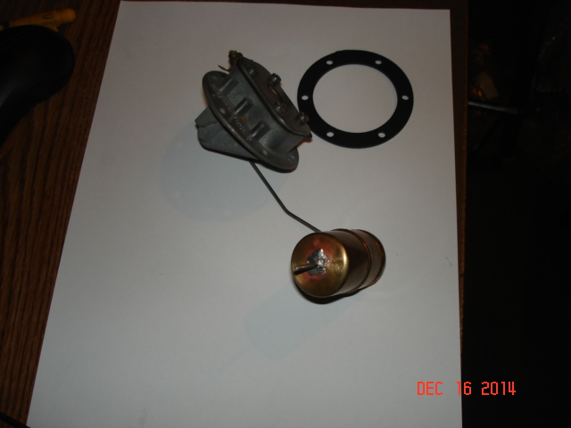

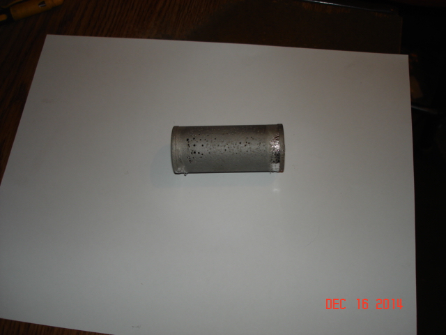

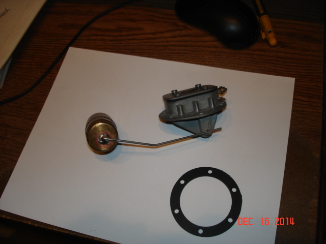

Continuing on...Since the fuel sending unit was on back order, I decided to see if the old one was even salvageable. Originally it appeared to be eaten up from the alcohol in modern gas. I should have taken a before pic. The best description I can visualize is it looked just like a bright white corral reef from the amount of growth all over the unit. I expected to see it completely eaten up after cleaning. The float is made of steel and was covered with rusty varnish pustules. With nothing to loose but spare time, I decided to sand blast, sorry that would be glass beads, not sand, to find out how bad it really was. VERY BIG SURPRISE! It actually cleaned up extremely well. The surface exposed to the old gas was textured, but almost no real loss of metal. It is just good now as was before the long time sitting as gas went south and farther south. Now the float is a little different story. It was still full of old gas, from 2004 and 5 gallons added in 2006, but sitting out of tank for a year now. It wasnt dribbling or leaking at the moment, but decided to blast it as is. After being hit with media, the old gas started trickling out. I know, not a smart thing to sand blast gasoline. I washed out the remaining old gas and finished blasting to see how bad it was. The float is pelted full of rusty pin holes that had varnished over. My first thought was to solder over the whole float. But I never had much success with getting it to flow very well on porous raw pitted steel. Then considered mixing the infamous JB Weld up and smear a layer over the float and cover with a piece of foil. After washing off the remnants of media, I used a heat gun to dry it out. Then the solder started dripping off float, so I came up with a better idea. I ended up using a stock Ford float that has been manufactured since 1953 and the last time I looked still had the old part number from back then. It fits just about every Ford thru the 90's. Anyway I chucked it up in a lathe and drilled a 0.079" hole in both ends. Then slid it over the end of existing float arm. Soldered both holes up and now works just like the original was supposed to.
The old float blasted clean. All of the dark specs are pin holes. They are all the way around it.
I removed the top cover and was relieved to see the coil had not bee affected at all or showed any signs of damage. It also ohmed(is that a word) out thru the full swing of arm. So now all back together and ready to install in tank when finished being cleaned out.

Can't tell for sure from the photos, but it appears your sender has a somewhat common problem: The base of the sender--where the screws that attach it to the tank go through--is somewhat warped, probably from someone torquing down the screws to try to stop leakage. We have the same problem on our 100M, and the repo tank doesn't have a perfectly flat surface where the sender mates up. We tried all kinds of gaskets and sealers, but the only thing that worked was a cork gasket my dad made. All the parts houses only stock the rubber type you appear to have, and it didn't work for us, neither did the hard plastic gasket the tank fabricator supplied. I'm leery of cork with gasoline, but Dad says they've used it for years with no problems.
