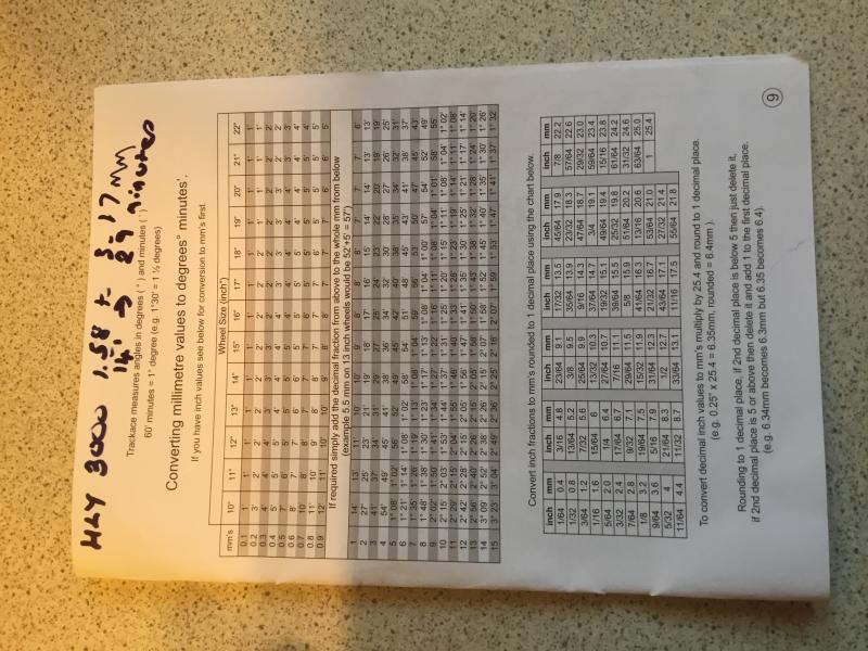

View attachment 65233This should help converting millimetres or inches to degrees “minutes “ came with my tracking tool

see my earlier reply with photo, this include a conversation table, based on various Healey manuals should be between 14 and 29 minutes
