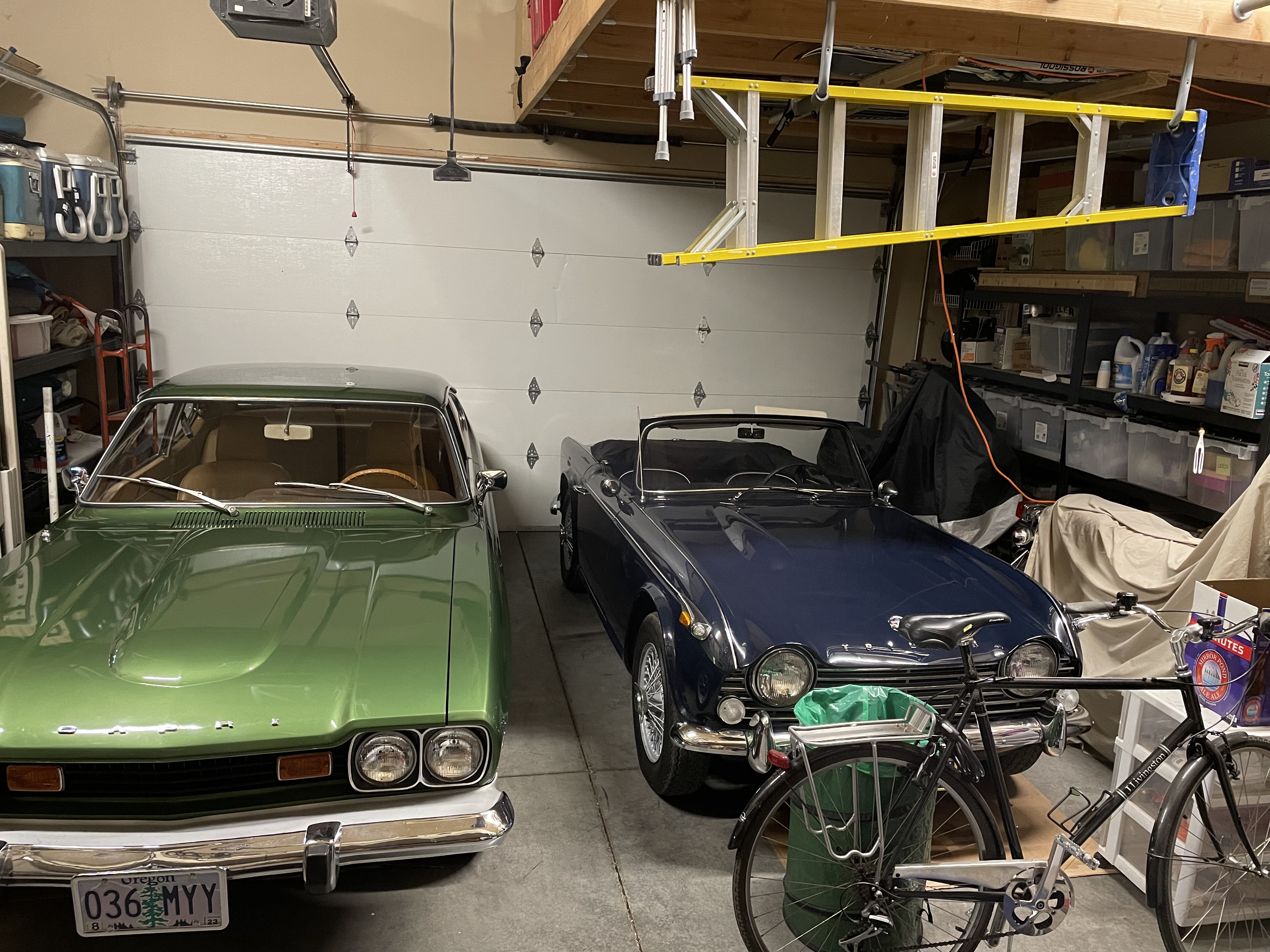

Federalees
Dollies are great, but with two cars and two motorcycles in a two car garage, there’s not a lot of room to move around 😁
F
Federalees
That Capri would be a rare car in North America.
It is! I was looking for one that wasn’t trashed for about 12 years. This one popped up for sale about a mile from my house just a few months ago. 80k miles, all original no dents or rust. It’s a unicorn. Triumph parts are much easier to source. 😜
