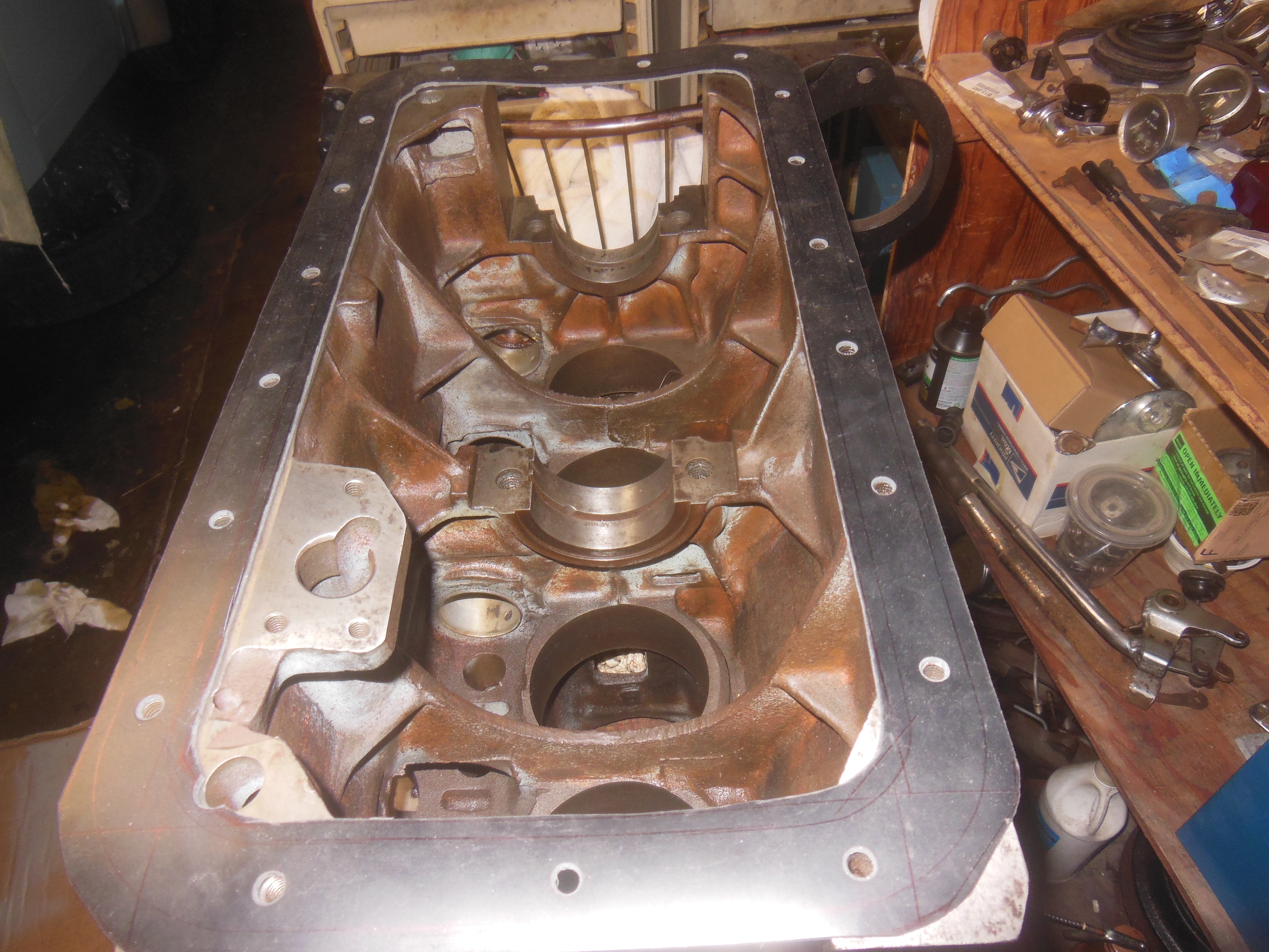

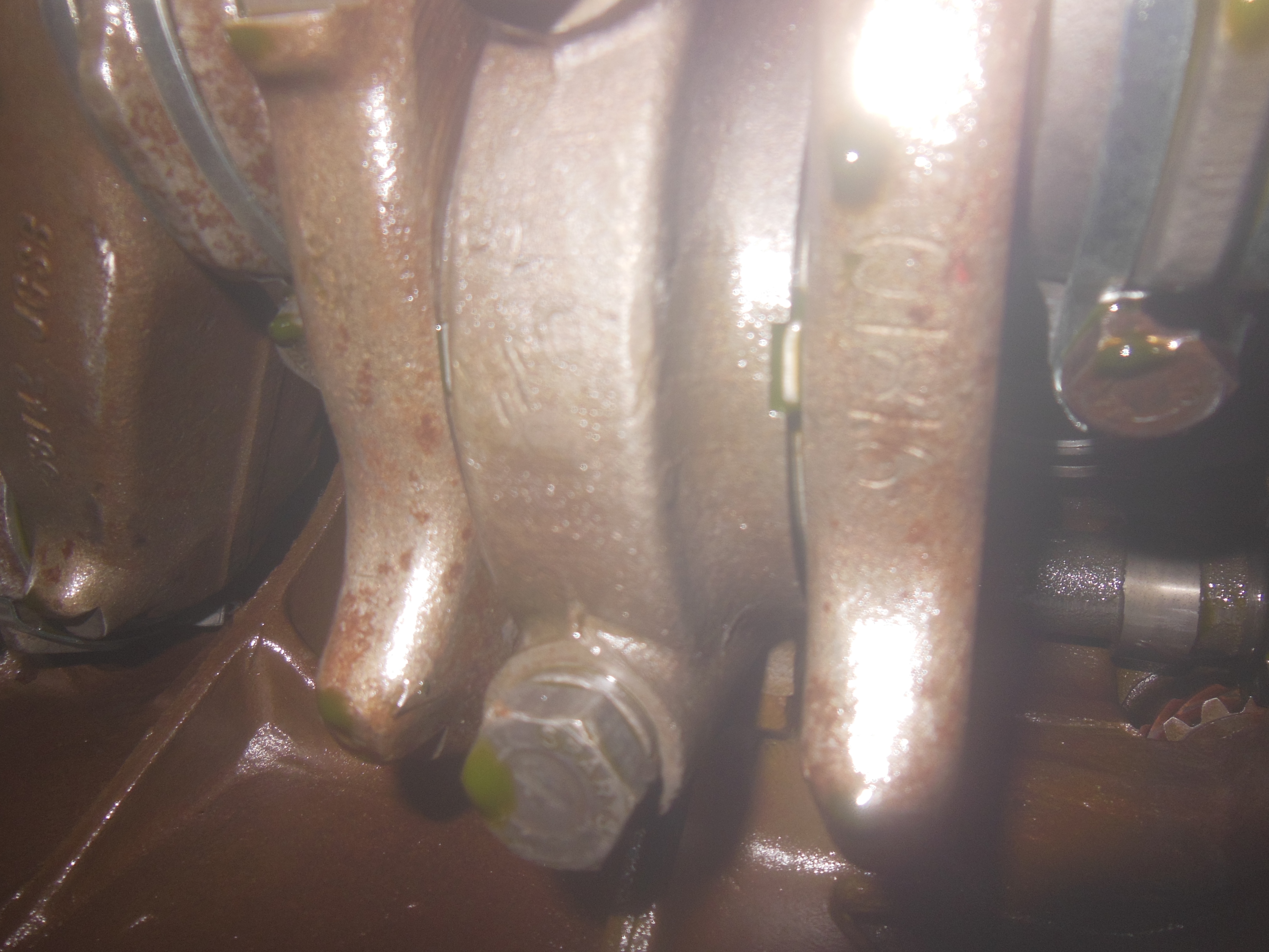

I finally got back to the oil pan gasket and got looking around for whatever. I noticed one thrust would move and the other did not. This is probably because the engine is jacket up. Anyways, I used the old thrust washers on this engine because I am afraid of aftermarket parts. Are thrust washers something that is a potential problem on a tr3 engine? I think when I let the engine down the crank shaft will go back to a floating position.
I am now just looking into the gap on thrust washers for a tr3 because I know so little about them, but my hope is the engine is built strongly in an old style and a little more play in the thrust washers should not matter……..
I made the gasket out of a 3mm rubber sheet from across the pond.
Thanks for looking I am concerned about the rubber gasket; time will tell

Nice gasket! I would be inclined to install that one to the pan dry, with only a touch of sealant at the front and rear bearing cap splits.
The engine sits in the car tilted to the rear. This means when it is running, the crank leans against the forward thrust washer...so all the way to the rear-most position. When you press the clutch, the pressure from the clutch pushes the crank against the rear thrust washer, so fully forward.
I might accept a few thousandths crank motion for and aft, above the spec. If it gets to be too much play, then the constant for and aft motion of the crank during use will start to put stress on the rod bearings, and could affect clutch operation and/or rubbing of the front crank sprocket inside the cam chain cover. Since you pan is off, you can check for most of these potential problems, and decide if the play is an issue or not.
I never thought about not using any sealer. I like the idea. I bought the large permatex non-hardening, but yeh sure would be a lot less messy.
The one problem I potentially see with the gasket is I punched the holes into it with a ¼ punch that leaves a slightly under 5/16 hole to keep the holes closed up as much as I could. I am thinking I should have given more wiggle room for the bolt. Without using gasket sealer, doing a dry run without the sealer might be the way to go.

Steve, have you considered measuring your crankshaft float? That would answer your thrust washer clearance questions without having to remove a bearing cap.
Steve Baker
I must admit I have never measured the float before. I just used the old parts. What is a good way to measure the float? I would imagine a feeler gauge on each side of the cap or maybe when the engine is up like this I could simply measure one side.
What is the measurement and method commonly used to measure the float?
Thanks steve
There is a method to measure it with a feeler gauge in the manual. You are looking at .004-.006"

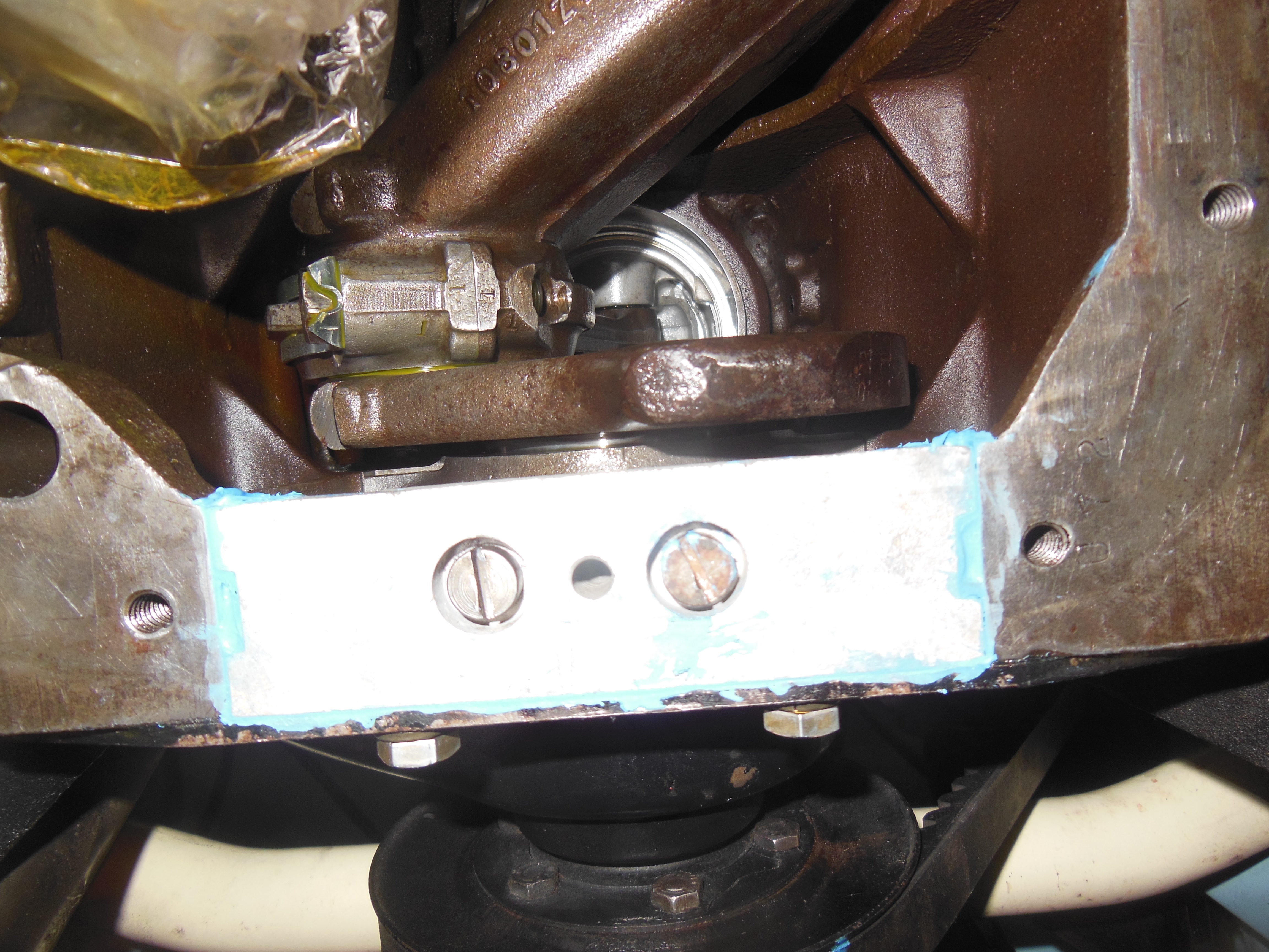

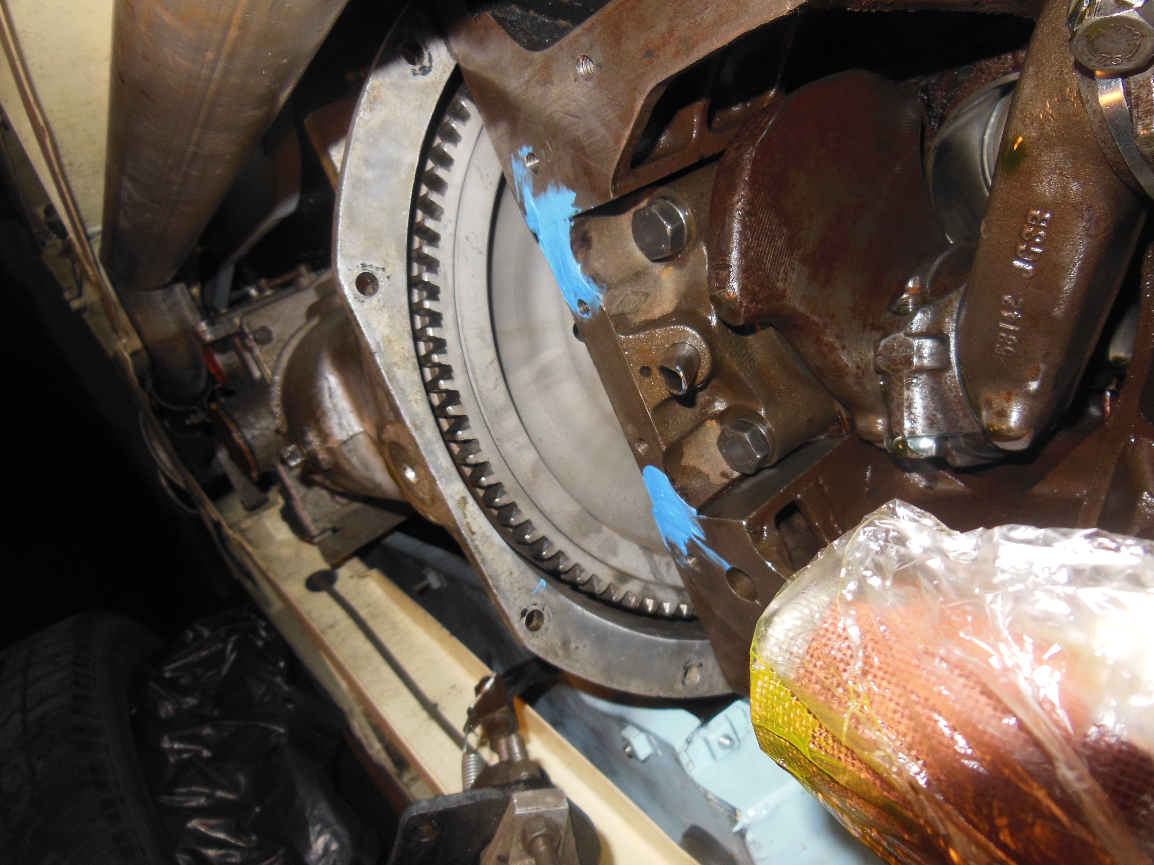

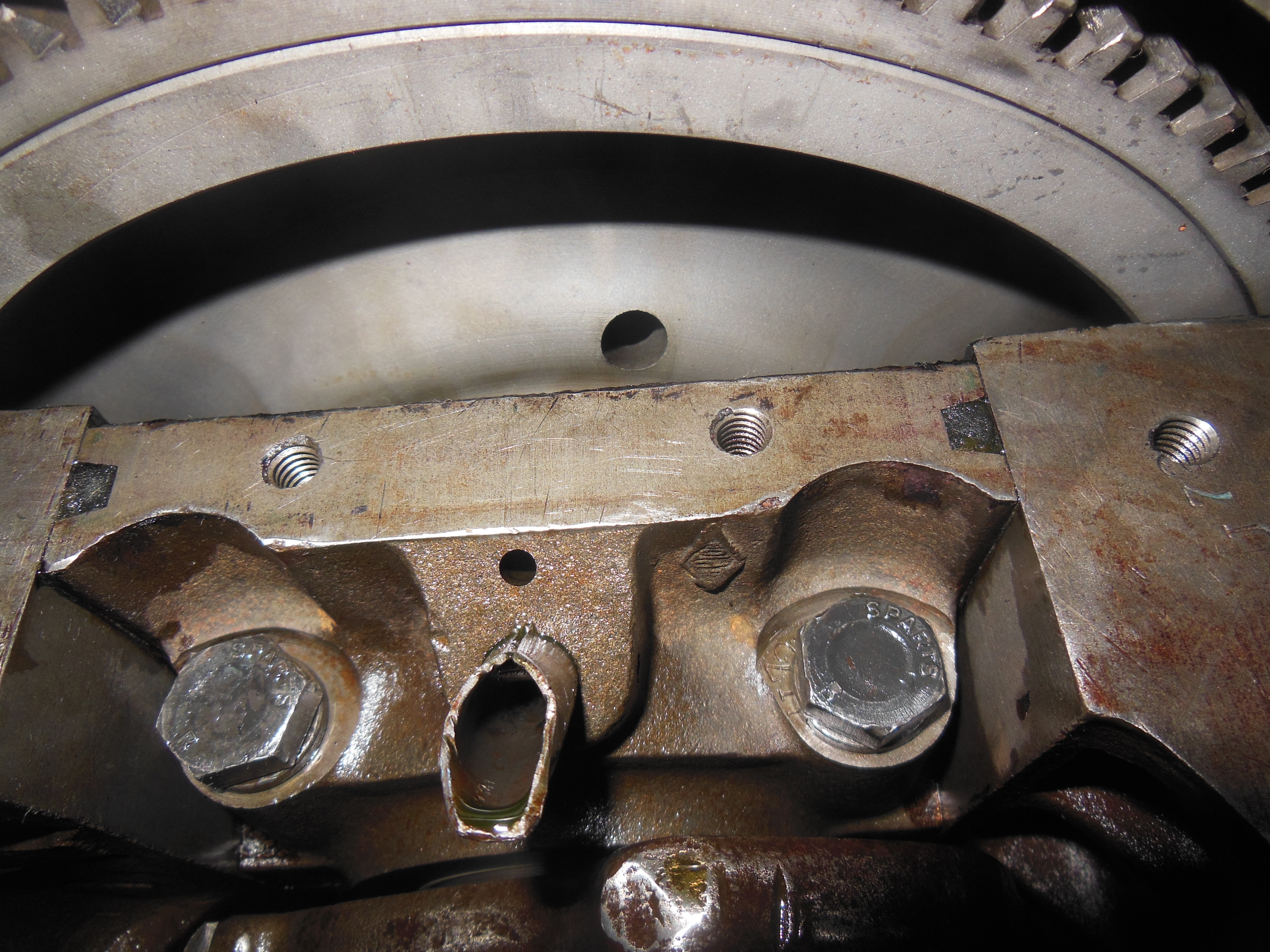

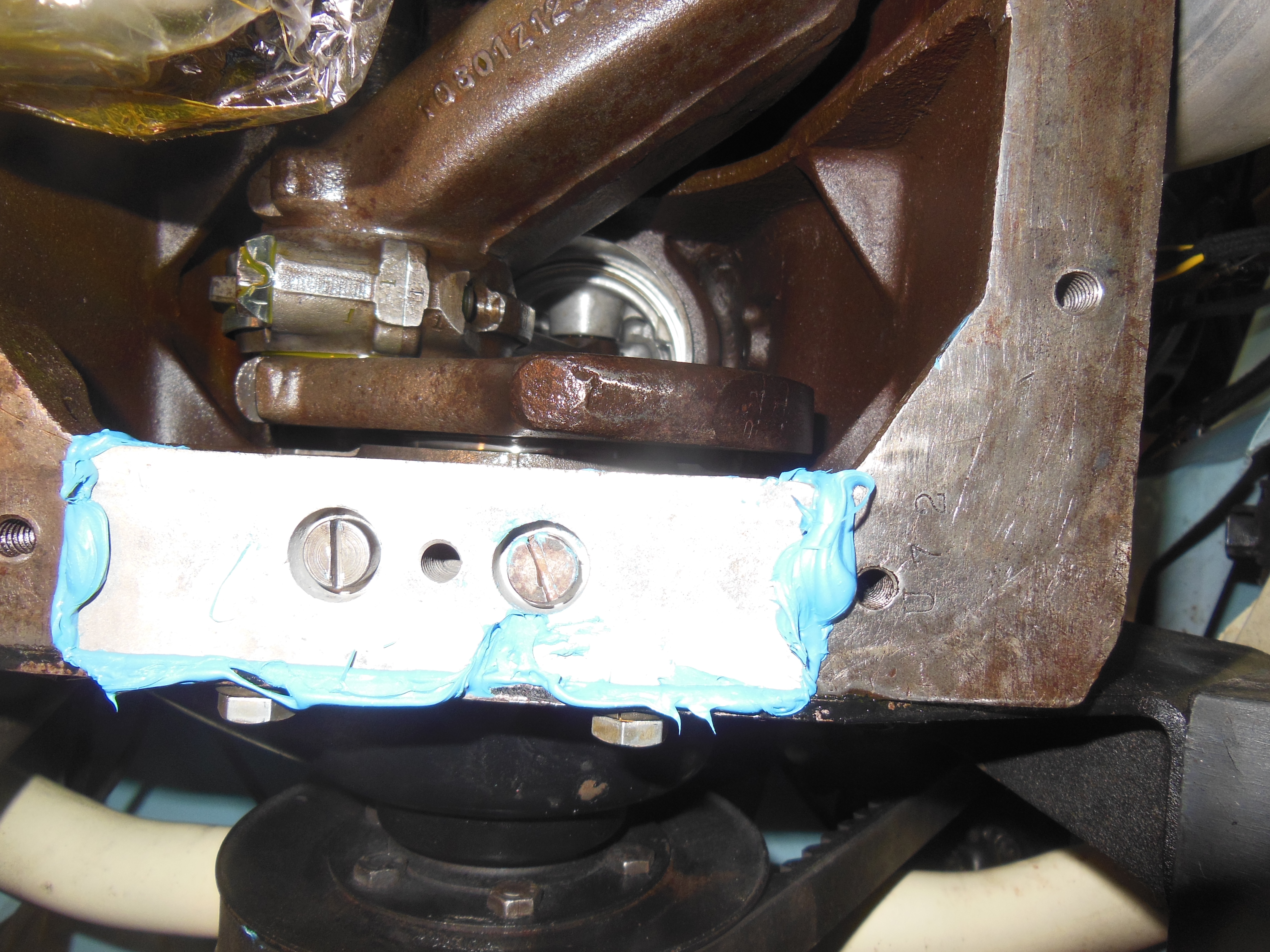

Ok I got the oil pan back on and sealed the seams in the aluminum piece and rear cap with some sealer on the seams. It was clearly leaking before at the aluminum piece. I removed the piece, cleaned the area up with Brake clean and rags a few times then gooped the piece up with the sealer and carefully put it back, letting the sealer squish out and then trimmed the sealer with a new razor.
Now I need to torque the pan down, but not sure if I can make the book's torque speciation without freaking out. The book wants 16ft to 18 foot pounds. I have an old memory of the problem about torquing pan and KVH mention the same thing.
I have a nice ratcheting torque wrench that goes up to I think 150ft pounds, but again perhaps the lower ends calibration might be off. I torqued the bolts down to wrist strength which could be 5 to 10lbs I do not.
I really would like some success here because I have fought leaky Triumph pans for too long. Any ideas on the torquing problem please speak up.

If you measure the send float and it is in excess(more than .006) an over size thrust washer is available.(.005)
It is permissible to use one side a standard and the otherside an oversized to achieve the desired spec of .004
If this is too tight, the steel side of the bearing can be sanded on a piece of glass to get it to .004 oversize.
And always use an assy lube and make double sure the washers face correctly.If done wrong they will spin and
damage both block and crank (usually fatally).

Well, since I rebuilt my engine 4200 miles ago, I figured my end float would be good, but I had a surprise after checking.
It took a lot of gymnastics under my car to mount the dial gauge, but I think I got it square and correct. If I push the clutch pedal in and out my dial gauge comes to rest at about .0075, out of spec. My manual calls for .004 to .006. However, if I take a video of the gauge movement, I can see the gauge pop as high as .009 before coming back to rest at .0075. I suppose I could just wait and check again after another 1000 miles but I'm curious what others here think.
Any thoughts? Thanks all. Happy Holidays--and to a Great New Year.

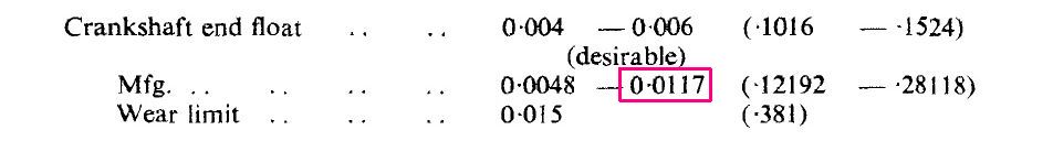

The table below is what I found in an old post from Randall on this same subject of crankshaft end-float. The point of the discussion back then was that .004 to .006 is “desirable“ but that permissive manufacturing tolerances could actually go as high as .0117.
I’ve also read online from hopefully reliable sources that using the clutch method to determine crankshaft end float can be a little misleading because of the great pressure applied to the flywheel, especially if the dial gauge is mounted on the frame of the car, increasing the likelihood that at least some of the movement is the engine, itself, moving ever slightly on the engine mounts or even pressing so hard on the thrust washers as to press out a typical or expected oil film of some measurable thickness.
Randall‘s point back then appears to be in response to a concern that .008 might be seen as excessive crankshaft end float. He felt that would not necessarily be the case based upon the more specific information he was able to find in the manuals.
My conclusion from everything I am seeing is that the strategic placement of the dial gauge and the use, or non-use, of the clutch method for measuring end float would be material factors in evaluating any situation where deviations from spec are minor.
IMHO a NOS set of washers might be the hot trick as the .005 over will be too much. Mic the old washers to
compare with the new. You should pick up a few thousands of tightness.
