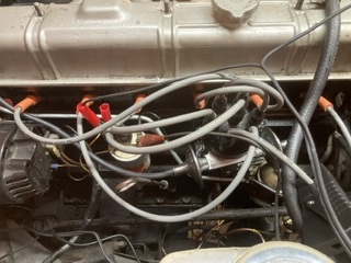

-When cylinder #1 is at TDC the rotor is pointed to 1 o’clock-cylinder #6. So the distributer was installed 180 degrees out?
-I wired the cap so the 1 o’clock position goes to cylinder #1 and the others accordingly.
-Advanced Distributer recommended setting timing at 14-17 degrees BTDC at idle, I set my static timing at 14 degrees and used a test light to set distributer position with test light. Rotate Dist. Counter clockwise between to lobes- no light, then clockwise until light just goes on-contact with lobe.
-Here is where I’m confused, my timing light does not light timing marks if connected to #1. It does register the timing scale if I connect it to #6! The light was showing about 20 degrees maybe a little more BTDC. And 15hg vacuum.
-I rotated Dist. Counterclockwise to position (in photo) bringing me to 17-18 BTDC with 10hg and engine not running as well.
-I tried putting plugs at distributer in normal pattern and the car wouldn’t start.
This all doesn’t seem correct or make sense to me to me?

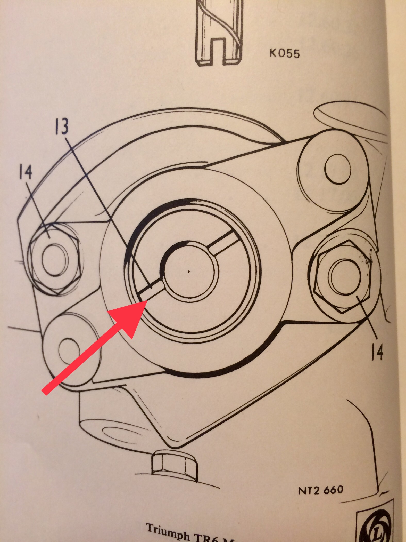

Distributer drive gear was 180 degrees out. And it’s a bitch to get out, until you find the magic tool (mini pry-bar).
Switched gear around, off set towards engine, line more like 2-8 rather than 1-7.
Checked my end float for drive gear. I had no gasket, but looks like I need a .0835” gasket. Where can I get gaskets for this or what type of material do I need to make a gasket?
Gliderman8
Gliderman8
You might also check Moss Motors to see if they have it.
Platinum
For future reference, the geared shaft with the offset has the center hole threaded 1/4"-20 thread. a long 1/4-20 bolt makes it EASY to pull it out and reposition.

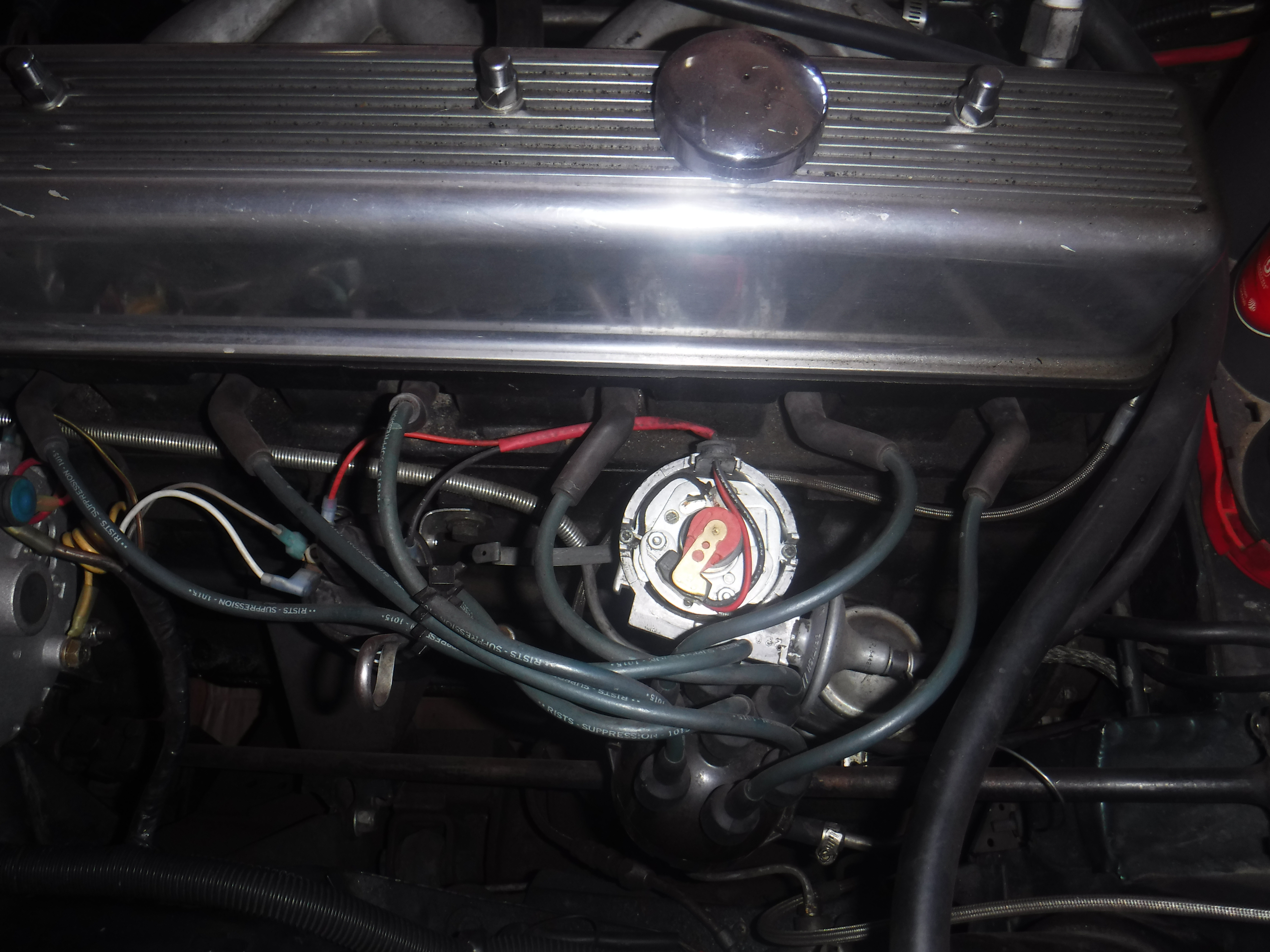

What distributor do you have?? here are pic of my 1973 TR6 and my 1972 GT6. They are vac retard that only work at idle or low RPM. yours appear to be low RPM vac advanced won't work
