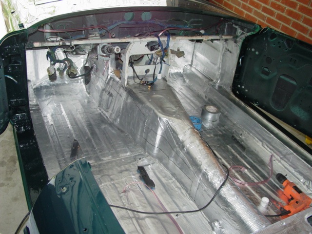

Dennis, fatmat is a sound and heat insulation that I covered the entire interior with, looks like shiney silver in the pictures. I lay'ed it 3 layers deep on the floors and transmission tunnel after sanding and painting them with rust bullet,the rest of the car only needed 1 layer. It makes a termindious difference, no more heat radiating around your feet and almost no road noise from the inside of the car. It is the best $100.00 I have ever spent on e-bay. I also used their liquid sound deadner inside of the door cavaties which brushes on, now the doors do not sound hollow when you shut them and the door speakers sound better as well as stopping some rattles. Fatmat is like dynamat only less expensive.100 sq. feet will do the entire car with a little left over, search for fatmat on e-bay.
