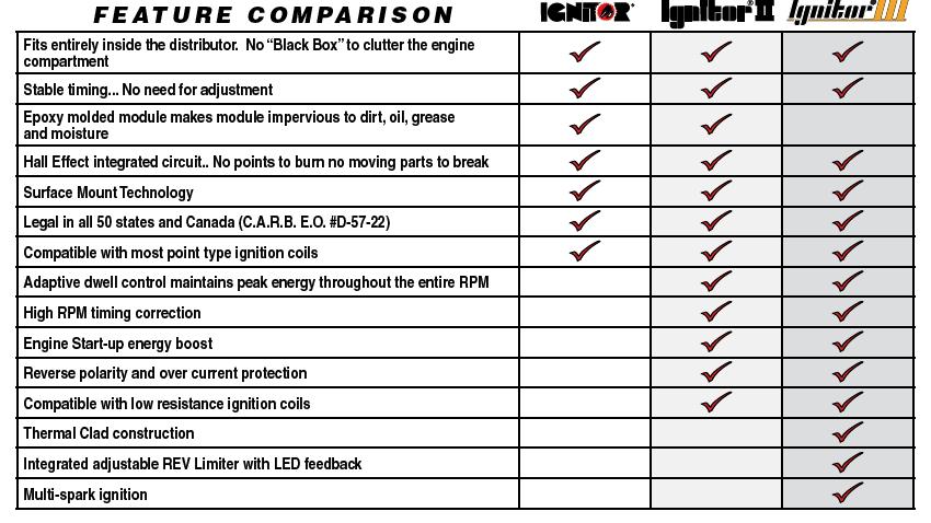

Assuming you have a stock distributor with an Ignitor module installed, there is no protection against reverse polarity or even leaving the key on too long. Only the Ignitor II & III have protection, and they're not available for the original TR3 dizzy.

Thanks guys! I think we hooked it up backwards, and the voltage we are getting from the battery to the coil drops to 10.5 when starting the car. So, we are gonna try a better battery first...then go from there.
