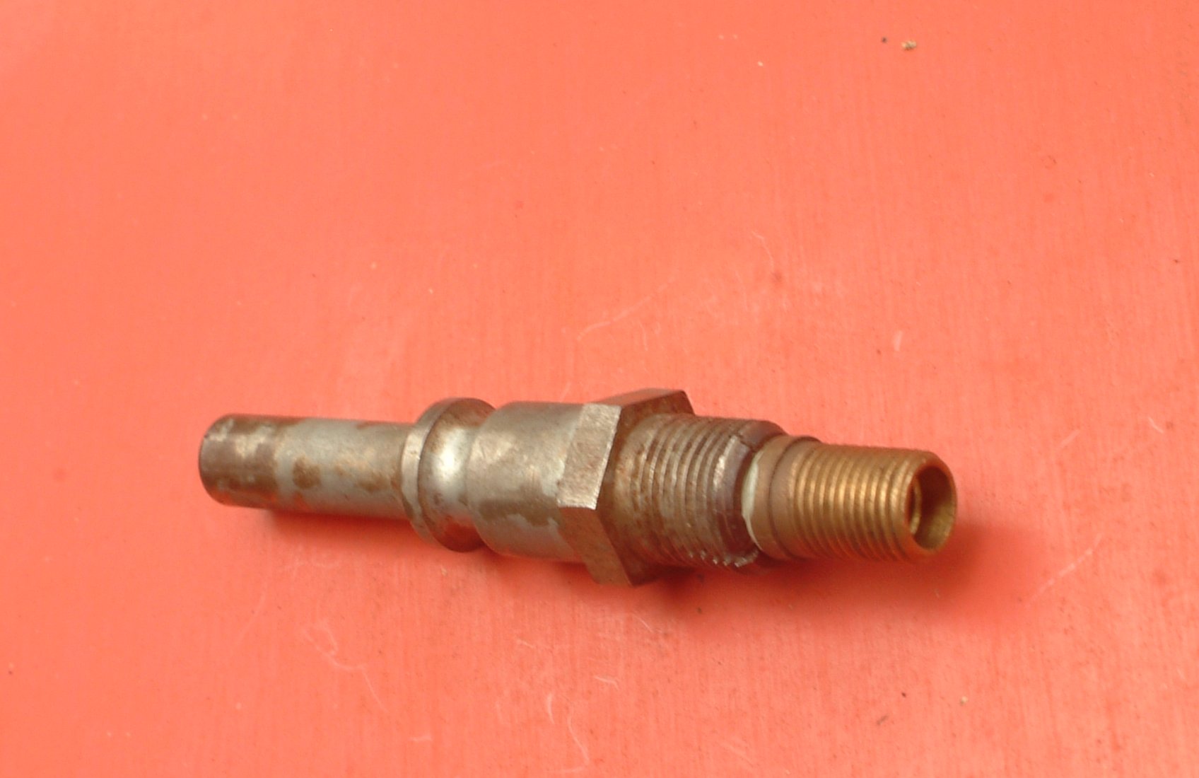

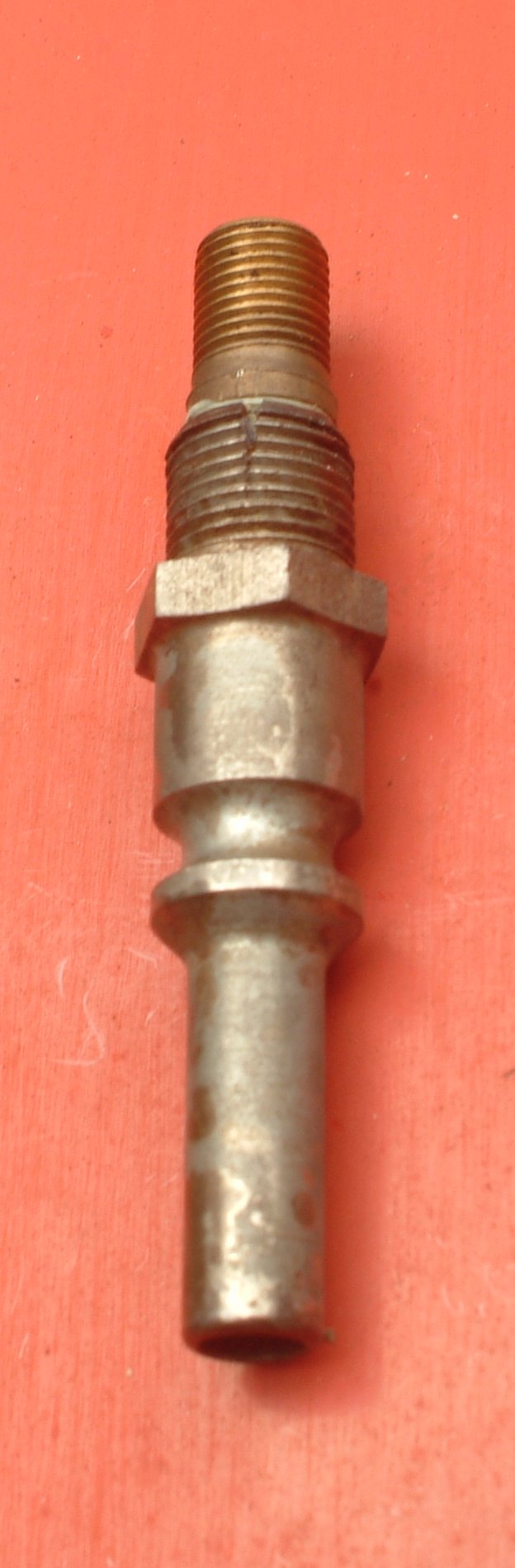

Clutch bled in seconds, took longer to rig the Eezi-Bleed and clean everything up after the deed. I built an adaptor to use the male end for an air chuck mated it to a Schrader valve so it can use the compressor (regulated down to 10 PSI) as the air pressure source.
I.D. threaded the air chuck, used epoxy instead of Teflon tape. It split the chuck a couple places but doesn't leak and maked finding a low pressure air source easier.
