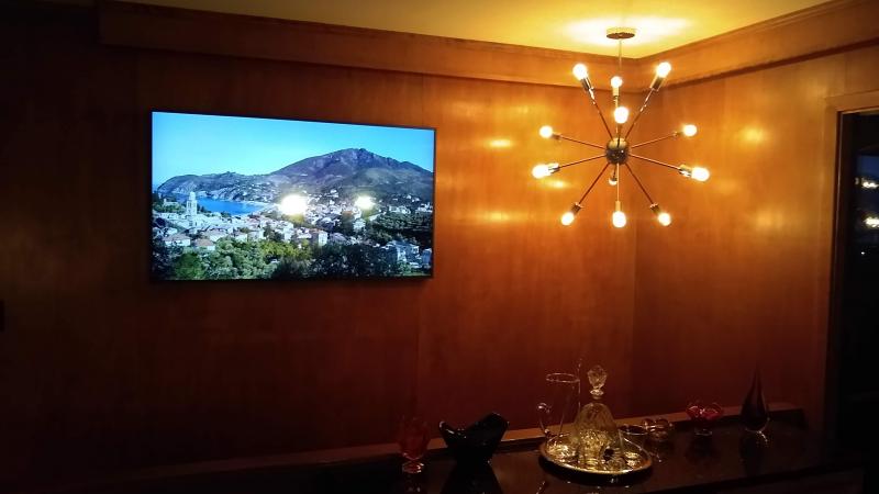

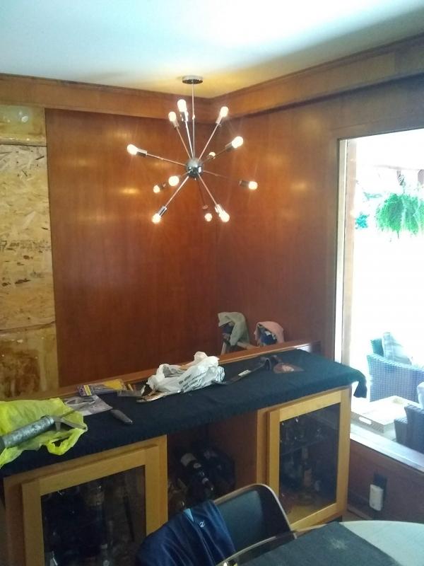

IMG_20190811_123728353.jpg lost a window when we put the garage in, had to match the old paneling (old to the right of the corner, new to the left)

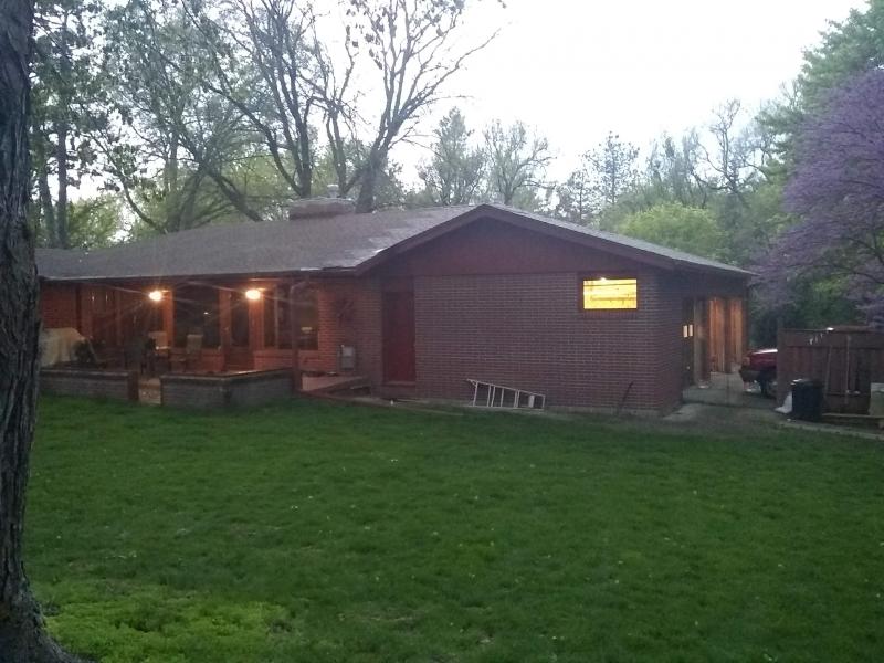

IMG_20190418_185839152.jpgtrimming out the garage addition

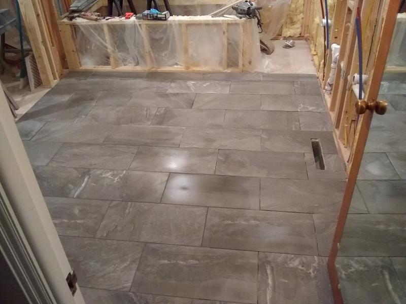

IMG_20180318_231534244.jpgnew bathroom

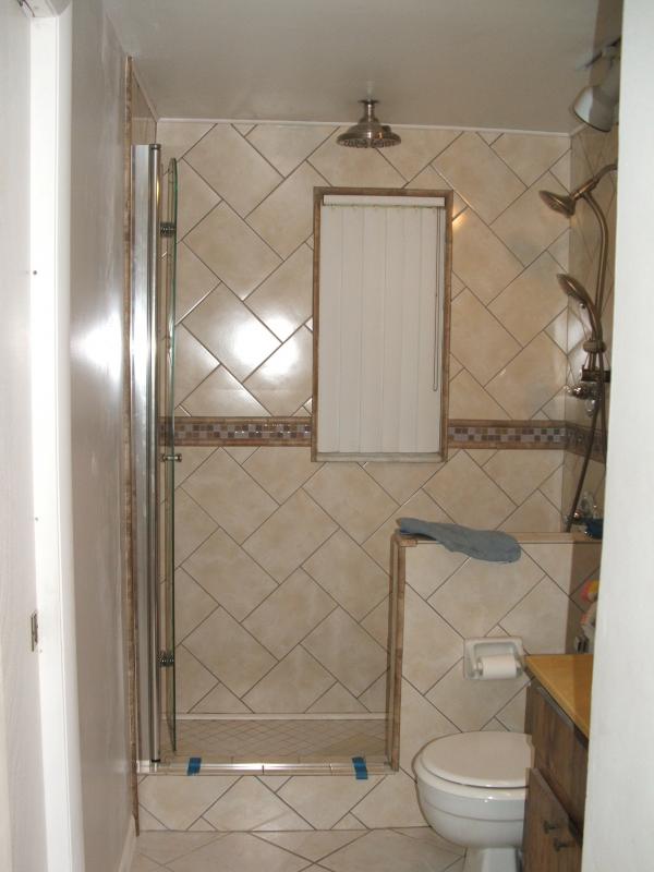

Told Mitsy I'd hose her off inna back yard while I replaced the tub with a shower... that didn't go as planned. :smirk:
Took a week to do the job, but it came out well in the end:

Doc that's a nioce job for a non-prefab shower! I see three different shower heads - which one shoots the CAB?

What is the point of having three shower heads? I can't help but imagine that the plumbing looks like this in the walls.

Choices. Overhead "rain pan" 'cause Mitsy likes it to wash her hair. That is on the upper control. The lower control is for the two heads at the wall, one high stationary and one on a flex-line. A "switch" to choose which one gets the pressure.
One friend said there should be a brass plaque on the wall with instructions, another said it looked as complex as the space shuttle.
Plumbing comes down from overhead, 10" apart, supplying both mixers. All CPVC. Output to overhead and wall are simple; overhead goes up between supply lines, wall goes to the right and up to the wall mounted head. Four lines, two diverters, all neat, straight routed. No "Spaghetti!"
