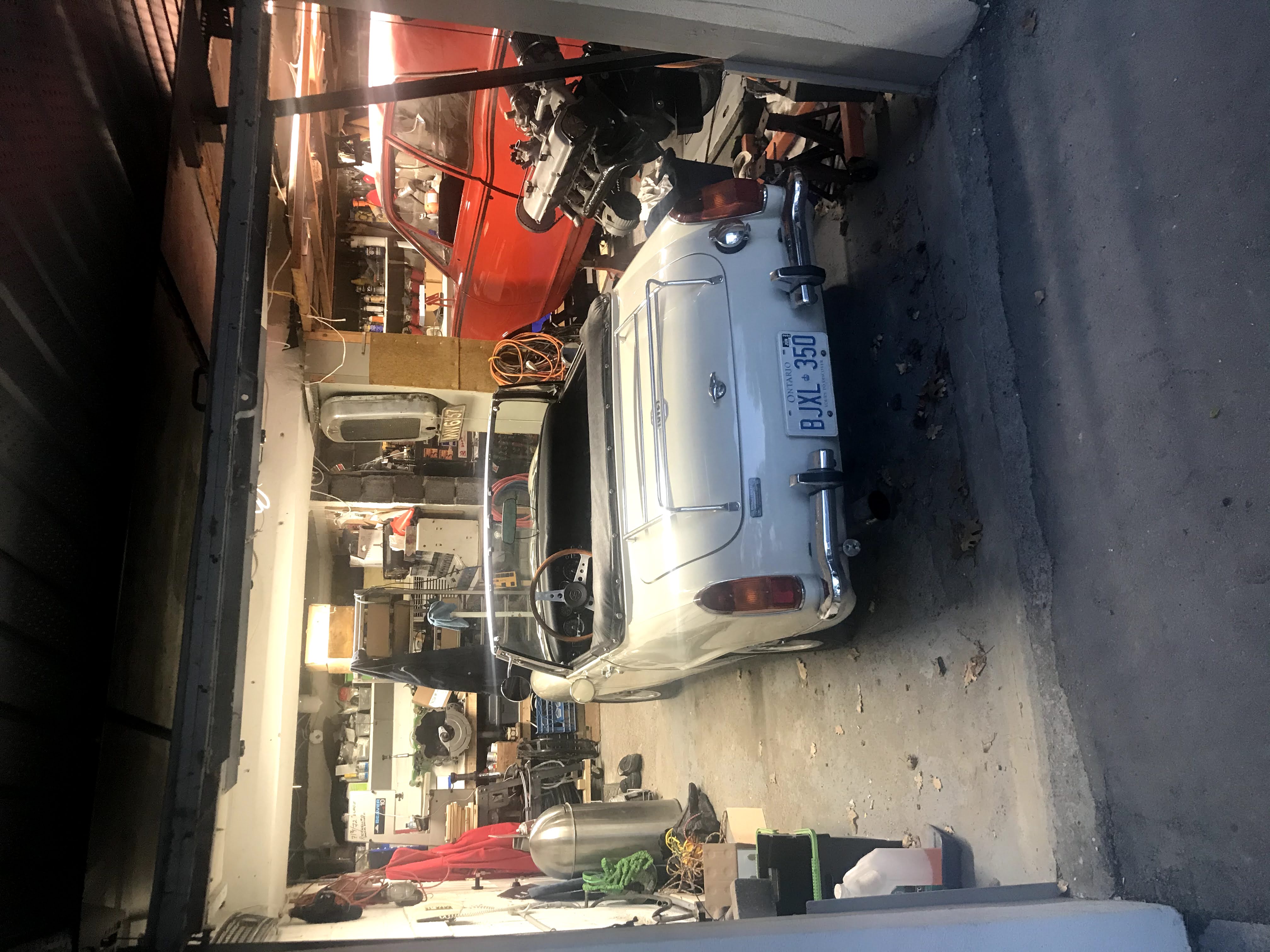

Here she is tucked into bed for the night.
