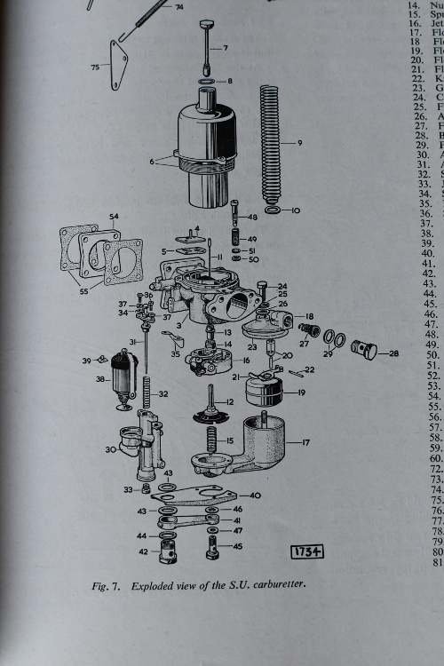

No rubber diaphragm in the SU's after 1960 or so. The earlier ones had one below the chamber, as part of the jet adjustment assembly. The HS4 from an MGB has the piston as their only "diaphragm". Stromberg replaced the piston & chamber with that poxy rubber thing.
The illustration in the early 2.4, 3.4 &3.8 litre Mk-2 Jag workshop manual, part #12 is the jet assembly with a rubber diaphragm:
