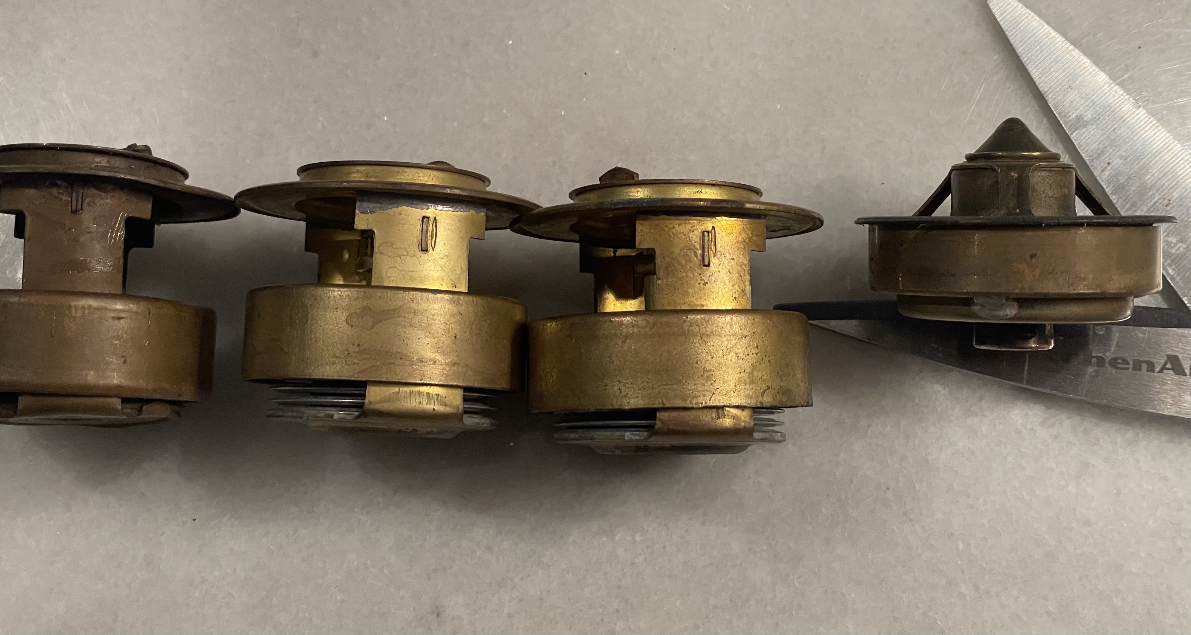

I have a few questions about the different types of thermostats I have for my Healey.
I have three thermostats that appear to be nearly identical to originals and one that I just removed from my engine in prep for engine and radiator flushing. The three thermostats on the left of the photo are nearly identical and the right one is the one I just took out.
Do the three larger thermostats blankoff rings rise when the engine temp coolant gets hot? Do the blankoff rings rise enough to close off the head port? Does the blankoff ring lower, goes down, to close off the head port?

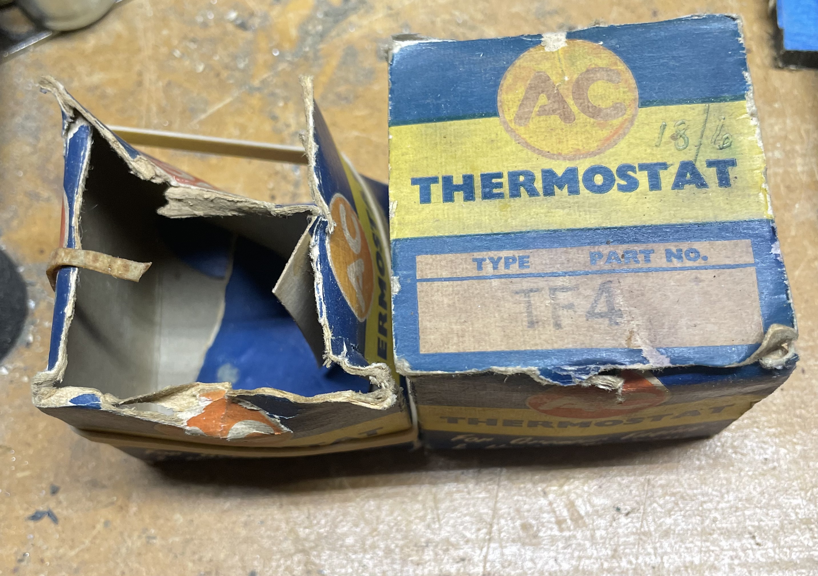

These are the original boxes my spare parts thermostats came in. Thanks for the posting of the Robertshaw thermostat. I guess at sometime over several years I purchased that.
I think the bellows thermometers that I have are good to use so next I will search for a 4psi radiator cap. I also downloaded MOSS thermostats photos from their catalog. How and why is the MOSS blank off ring used, with a non bellows thermostats?

I did more research and you have to understand whatbthosevTF1,2,34 codes mean when it comes to the operating temperature. I have a winter and summer thermostat in my parts inventory. BTW, I did not see what temp the MOSS thermostat is. I also noticed the huge price difference between the originals and afterwards thermostats. Maybe there’s a reason for the blank off ring?

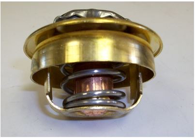

You can hedge your bets by using partial blanking.
