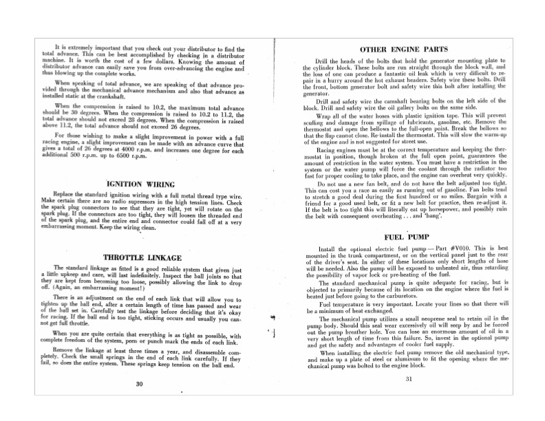

Those generator bolts can make quite a leak. I found that out the hard way. Best practice is to drill and safety-wire the bolt heads.
I don't think all those go through. Your block must have had a core shift that caused it. The alternator mount hole is constant, though!
Here's the page from Kas Kastner's competition preparation manual (page 31, as pdf and jpeg) that covers what to do with the generator bracket mounting bolts. The description is at the top of the right hand page, under "other engine parts"
