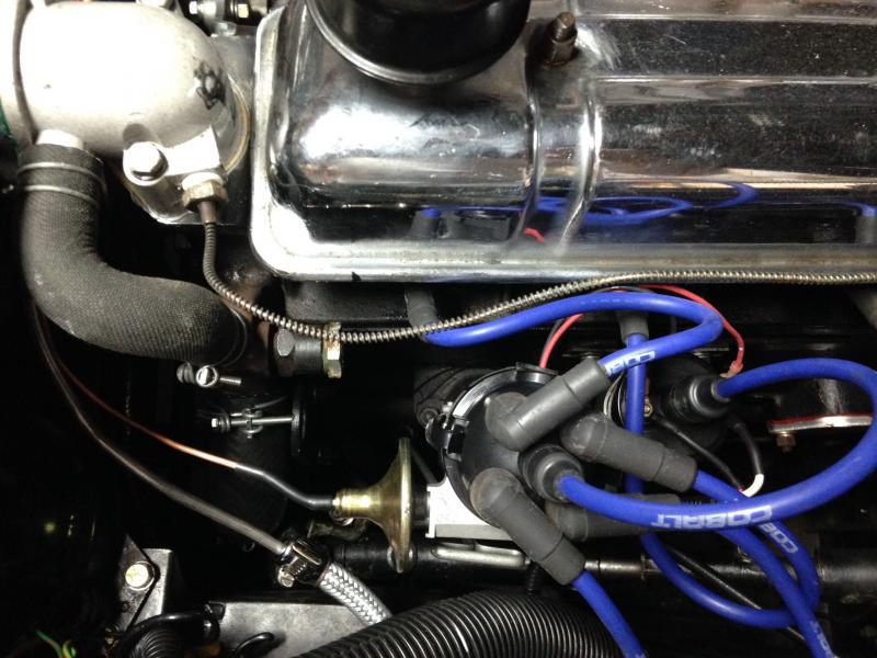

That just sounds like way too much, but if it runs good, then good. Just curious, I wonder if you were a full tooth off on the distributor installation, but sounds like they would have caught that. Again just curious, where your vacuum advancement line fitting is? Is it almost parallel with the engine or way out by the fender or way into the block? Maybe a picture of the distributor wires and advancement for my mental records in case I put a big cam in.

The vac advance line is close to parallel with the engine, slightly toed out.(I had it pretty heavy toed in before)
the mechanic didn't mention repositioning the distributor, so I don't think he did.
i'll take a pic & send it.

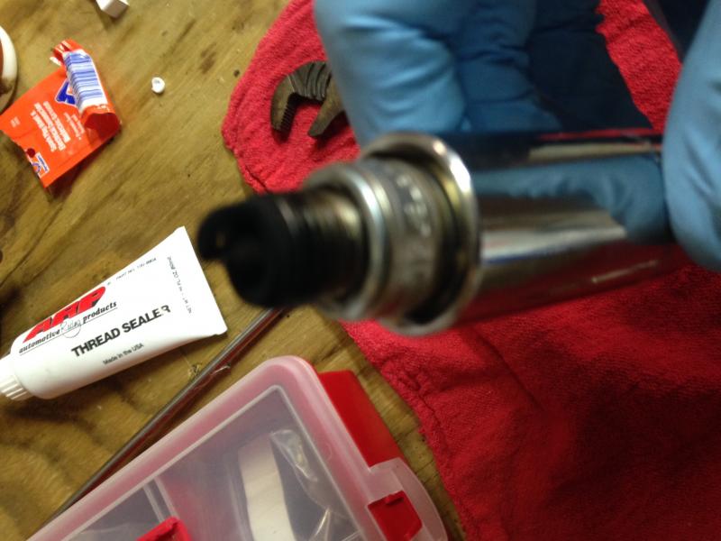

The shop put in Bosch platinum plugs.( im not a fan of) I found the front two were fouled & had a coat of black powdery carbon, the back two seemed fine.
therefore I'm thinking the front carb mix might be to rich. I've leaned it out (3 flats) and advanced the vacuum timing a little & will try it again tomorrow. Also ordered the old champion L87yC's.
here's a pic of the distributor alignment.
I used to be really fond of them, as they seem to last almost forever.
Then I had one where the gap mysteriously disappeared, and discovered that the other 3 all had the center electrode moving out of the insulator.

I can't even see the electrode on those bosch. it looks like a ceramic cone.
Normally that's right. The center electrode is entirely inside the ceramic insulator, and is very thin (like a thin mechanical pencil lead). But on these plugs, it had somehow come loose up inside the plug and extended out of the insulator towards the ground electrode.
The front plugs being black does sound like a mixture problem, but I doubt that is the cause for the intermittent cutting out. Generally once a plug is too carbon-fouled to run, it just quits working altogether. I'm thinking you're more likely to have a problem on the low-tension side, like maybe a ground or point lead that is broken internally. (Assuming I recall correctly that you've tried different points, condenser, coil, cap & wires without changing the problem.) The backfiring also indicates something worse than just timing or mixture.
