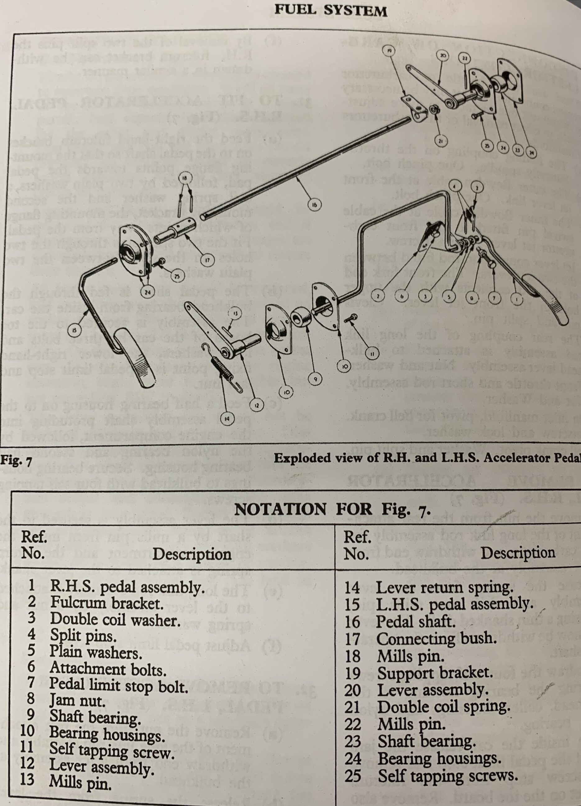

From the internet...

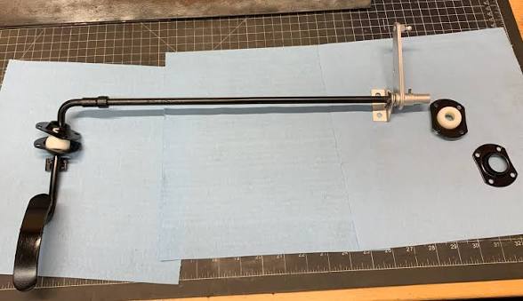

He might have that, too....

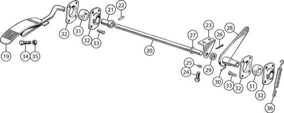

Thanks for the pic.
Thanks for the pic. I believe there is an issue with either of the pins in the diagram no.26 or 30 or maybe no.22??? Guess I'll have to take that area apart and have a look. Anybody had an issue with this gas pedal setup and taken it apart?
