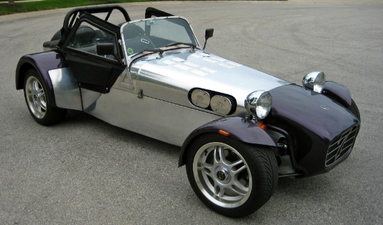

You might be able to still use the triple ZS's by putting a cut out in the hood like they do on Lotus 7 to clear the air filters:

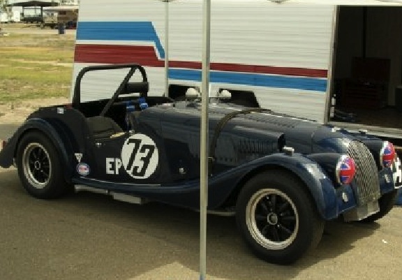

If the exposed air filters don't look good, maybe cover them like I've seen done on some vintage race prepped cars with a side hood scoop like this '59 Morgan has:
Unfortunately it's not just the bonnet that doesnt clear, it runs right into the fender, so making a hump wont work =( I've got a line on a 1971 intake manifold that will clear the hood properly.
