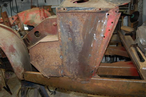

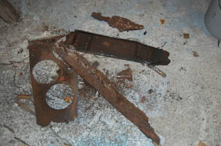

I got the #4 phillips socket and it turned out to be a pozidriv socket. Anyway removing the drivers side 3 out of 8 screws impacted out and the others required the drill. I stripped off the hinge pillar and the brace. Now it looks like its time to make some patch panels. I haven't found anyone that sells patch panels for scuttle side panels.
DSC_0046.JPGDSC_0047.JPG More fodder for the rust pile and more to come, Angus
Its morning, elections are over and we can get on with life. I appreciate the replies and checked out the suggested sources. They all sell the entire foot well outer panel but not a patch panel for the rusted out bottom portion. In the video that Martin provided with the frame a patch was welded on to the car they were working on. I emailed him and he didn't know of a source and suggested I make my own. So I'll cut some tin and take the hammer to it. Martin is going in for an operation today but hopes to be back in the shop in a few weeks. Good news I hope.

Randy, that's a good point. I didn't want to replace the entire panel, it would require a lot of removal and install effort and only the bottom was rusted out. So yesterday I banged out a patch and tacked it into place. In the future though considering using a portion of a panel is definitely a good idea. There is some satisfaction in fabricating your own parts but there has to be a limit. I find these British Cars and Motorcycles soak up a lot of time and money so you do it cause you love it. Though I cursed every one I owned and I fondly remember each.
