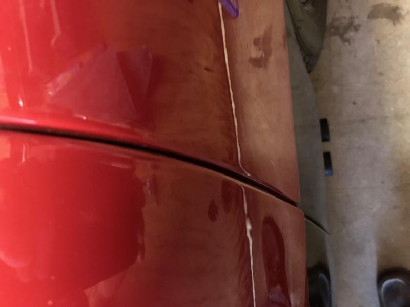

Hey Rob and Jon,
Gap along hinge edge is approx 18 - 20 mm where latch/rear fender edge is 8-10 mm, bit tighter at top of door. Passenger door is pretty consistent on both sides, about 12-14 mm each side. I wouldn't be surprised that the frame has sagged somewhat as original frame and car was raced heavily back in the day and suffered major front end damage before being restored in 2000. Of course I worsened this issue when I tried to correct the gap myself a couple of years ago and did not get it back as good as it was before I tinkered with it - remember my "if it ain't broke don't fix it" rule ! It is like the entire door needs to move about 6 to 8 mm towards hinges to equal the gaps out. I'm using a caliper but hard to get an accurate measurement. I don't see any shims between the hinges and either the doors or the hinge pillar. Seems like all the adjustment screws will allow is moving the door in or out, not the direction I need it to move. Anyway, maybe this additional info will help. Posted a couple of pictures. First one is left side gap and second is latch side gap.
Thanks again,
Mike

You could play with alternating some different hinges (number and measure them, looking for "thinnest" stack-up height).
You could also play around with "milling" some of the height away, but I'd split it between both mounting faces (door side and pillar side) and NOT take off the full height you think it needs on the first pass; maybe cut half or two-thirds off, then retest.
If the rest of the "alignment" is good, draw outlines of the hinge(s) on both door and pillar with China-Markers (aka grease pencil) which can be easily cleaned off afterwards. That will at least speed up the realignment process, and get you close to where you were.
One last tip, is to only snug up the mounting bolts, so that you can tap them around (use a block of wood and hammer) to fine-tune position. You'll never get anywhere if 1.) the door is flopping around too loose, or 2.) if the bolts are too tight to allow any movement.

Sounds like you need shims made out of dark matter, otherwise known as negative shims. Since they are exceedingly expensive if you can find them at all( billions of dollars and a no return policy from the vendor who is somewhere north of the Tesla in solar orbit), I suggest you do as has been suggested above and shave off some material from the hinge. They are pretty beefy on the 100 BN2 that I have but I think they were different on the BN1s. You can always shim them back to what you have now. Besides, who of us knows what the door gaps on cars as they rolled out new were like? Maybe all our door gaps are actually better than original and we should be marked down at the shows if they look too even......
Obviously there is a reason why door fit changes and I suspect it has little to do with doors and hinges and a lot to do with chassis flexibility. That said, I'd deal with it in any one of the methods mentioned, the negative shims being the best suggestion.

Hi Mike,
A while back, a friend who was watching me having a **** of a time setting the doors between the fenders, gave me some great advice. He indicated I had installed the front and rear fenders and would always fail trying to get even spacing when installing the door. His suggestion was to first install the front cowl and then the front fenders loosely. When installing the door, set the hinges to achieve even spacing across the sill and then go back and position the front fender to the door for even spacing. Next is the installation of the rear cowl with the rear fender positioned to the door. If all superstructure elements are sufficiently in tact, the door surround along with the fender-to-cowl beading will provide sufficient play to achieve reasonably even spacing. Small shim adjustment of the hinges will help after fender/door positioning is achieved.
Mike, when accepting delivery of my new Healey, the front fenders were set 1/4" above the door top and after I refitted all outer panels, my fenders to doors are even with good spacing all around...not perfect but very good. This was achieve by someone who had never done body work and with only the advice above.
